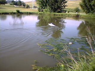

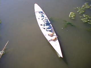

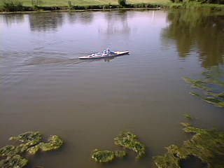

    Tirpitz hit the water at 0835 and had "its" sea trial. The boat turns very well and handled great. I did have to install a receiver battery pack as I was having an intermittent problem with the drive motor cutting out for a split second. After the radio was hooked up to a separate battery source everything went very well.
    Just a minute after I pulled up to the pond I remembered why I had gotten a Von der Tann kit. It was just as I walked with Tirpitz on my shoulder. I have got to get into a smaller boat.
    I took some pictures with my cell phone camera and will try to post.
    Thanks,
  8. Gettysburg114th
    How do I think the ship performed?
    Very stable platform. Turns very good at Treaty speeds. The ship turns in it's boat length. Starts well, stops in about 2 1/2 boat lengths. Should be a hoot to run and fight in battle.
