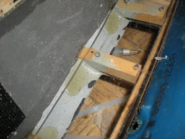

    Well I read about using the concrete sealant as a water channel and was especially interested in its self leveling properties.
    In my Baden the builder had used foam for the water channel and it left a large gap between the foam and the hull. Large amounts of water would collect in the gap and affect its handling.
    I added some wood behind each rib as reinforcement and to control the flow of the concrete sealant. I turned the boat on its side at an angle and poured in the sealant. It worked great. I didnt use it in the bow as I felt the epoxy with microballoons weighed less. Now when I pour water in the bow it runs straight to the center channel even with the bottle installed.
    I also added some thick lexan armor attached to the wooden supports. I really like the sealant except that I had to do several sections a night so it took several days to do both sides as I had to wait a few hours between pours. However the results speak for themselves.
    Thanks guys for the idea!

  16. Kotori87
    3,562
    Is there any chance you could take a picture from a different angle? Maybe a little further back? I'm looking at the attached image and I'm having a hard time figuring out what I'm looking at. Perhaps a different view would help me figure things out better.

  20. jadfer
    The previous picture was of the inside of the starboard midship with the lexan armor installed.

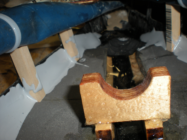

    This picture is of the bow of the ship.
    I tilted the ship to get it to have the slanted angle. So far in testing cups of water flow quicly to the center channel.
