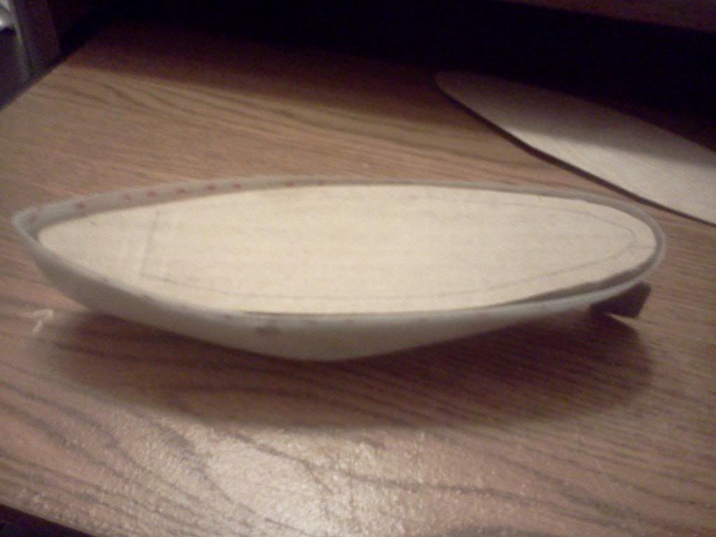

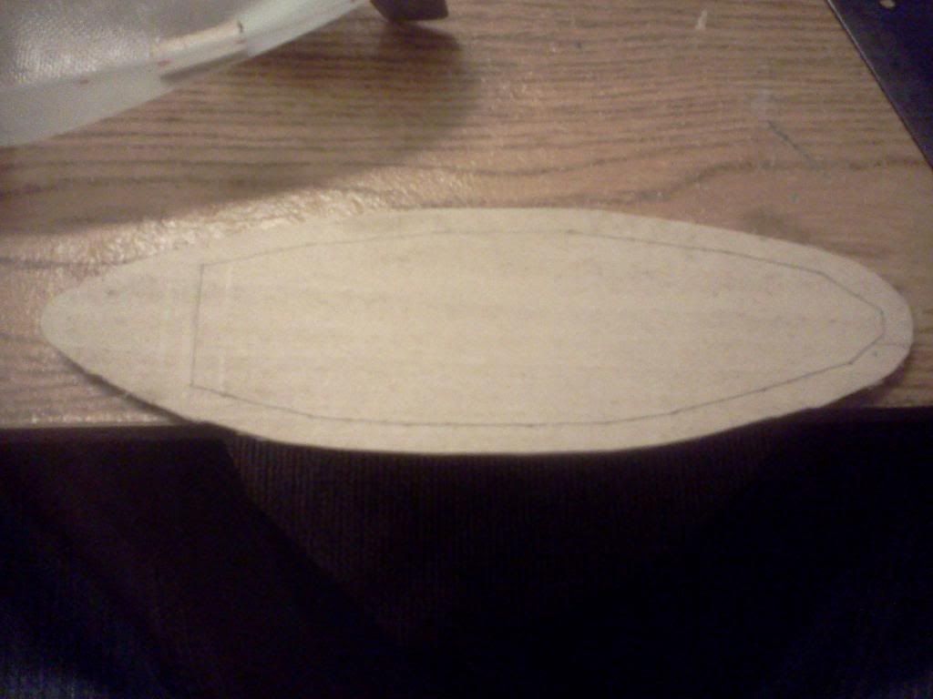

    now the pictures about i am making the deck but i am contimplating on what i should do. i soaked the 1/8 bass wood down and placed 2 batteries on it to give it a upward warm to the bow of the ship. but as you can see my lines i want to cut out there so i can access the motor and all the guts of the ship. but after i cut it out i will have 1mm of play and im also aftraid after i glue the outer deck to the hull that it might warp out of place. i need some input on what to do about this. thank you very much.

    You can glue a stringer or two under the deck before you cut out the hatch. That should be enough to keep the curve in the hatch.
