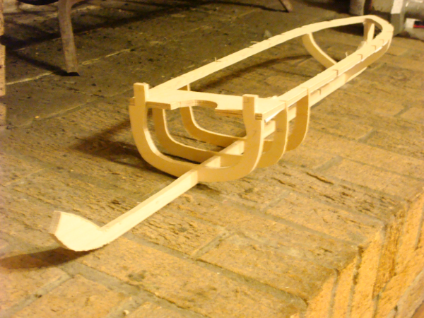

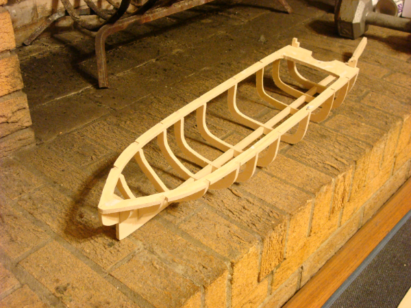

    Today great progress was made in that I got some ribs cut, along with the keel and rear subdeck. After I get the rest of the rear ribs fitted and I'm happy with that, the front ribs and front subdeck will get done. (Sometime next week, probably monday or tuesday)
    The funky-looking prow is the actual ram prow. The keel immediately behind it will be prettied up when I am fitting the front ribs (note the lack of notches forward of frame 7 [the closest one to you in the pic]). I really like frame 7 because it locks into the fwd and rear subdecks and I think that's cool :) The semicircular cutout in the front of the rear subdeck is to provide clearance underneath the 'A' turret. In the other frames present, you can see that two of them are 1/8" vice 1/4", which was done to get better support mid-hull (while staying under my solid% limit) without being hard to sheet. The ribs in the curvy parts are all 1/4" so I can butt two balsa sheets on them to accomodate the curves.

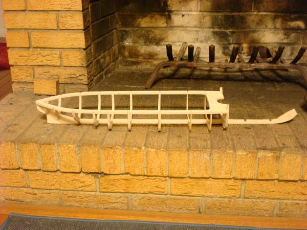

    This next pic is a bit blurry, but it shows the stern end.
    There are two frames aft of the sternmost one in the pic, one of them forming part of the 1" solid area there.

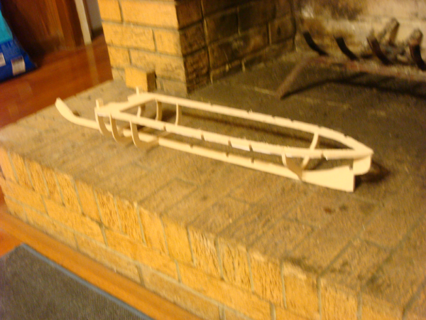

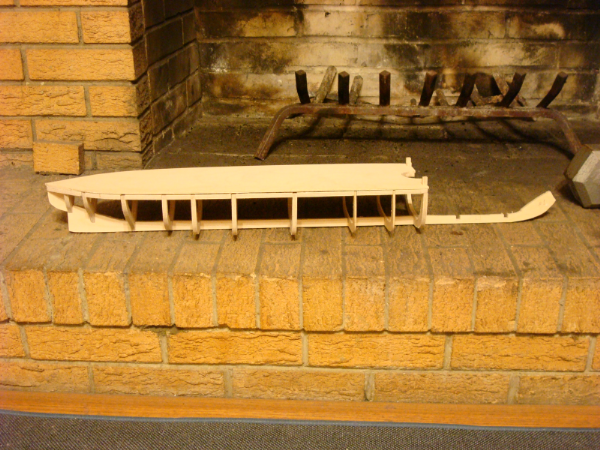

    Nonetheless, admirable progress was made; For your viewing pleasure, Effie #1 with the rear deck on, and all ribs aft of Frame 7...
    At this point, it's only held together by joinery, no epoxy is present. If a wooden hull isn't built well enough that it can be carried around without glue, someone is being sloppy :) If it looks like the deck doesn't line up with the subdeck and/or ribs, that's because it won't be sanded to final fit until I get them epoxied together. Then it'll be beautimus. Looking at the pics, it's hard to believe she's only 32.5" long.
    Above is the same view, but with the deck removed. Below is the view from astern, on the stbd beam. I like it because it shows the 'ears' on Frame 7 that are the step point in the hull, and the connecting points for the forward deck and subdeck.
