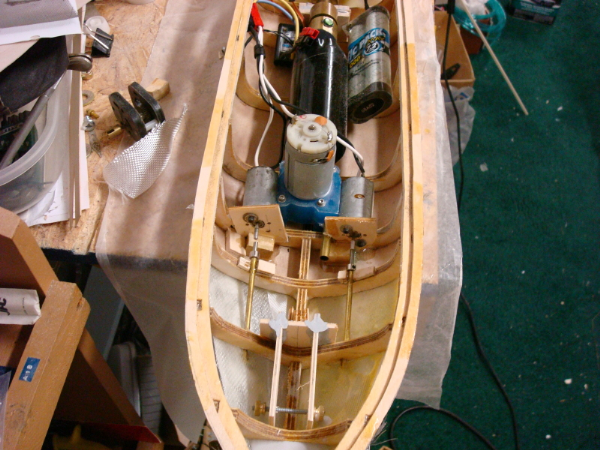

    Anyhow, this is the Evstafi build thread :) After many days of feverish work, great progress has been made; a few little things here and there are not what I had wanted, but time waas pressing and I likely won't make another battle for 6 months, so I had to do what was necessary. Below is a view of the back end of the boat. The packaging in the engineering section was VERY tight. The motors are right up against the pump, and the stbd motor mount was clearanced to allow the pump outlet to fit.

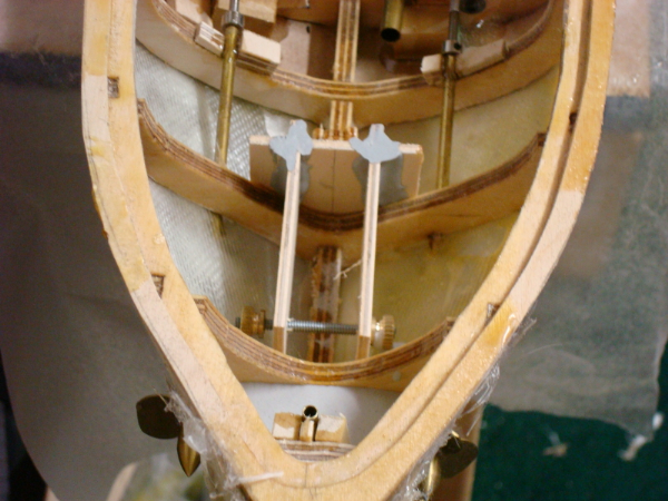

    Below, you can see the rudder servo mount better; I've always had crappy servo mounts, so I worked on one that would hold well and still be a quick change mount if needed. So, the servo slides in between the two long arms, and you tighten the thumbscrews to hold it fast. There are little pieces of wood to hold the servo in the vertical direction to guard against shifting under load over time, put in after this pic was taken. The gun servo has a similar mount as well.

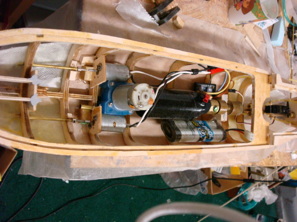

    Another view from above and aft, we can see the gas bottle and battery making appearances. I will have to put in ballast on the port side to counter the 288g weight of the battery, minus the equipment that goes there. The space on the port side is going to hold the pump switch and the Spektrum receiver. (I know the ESC is there, it's going to move down and to a more centerline location)

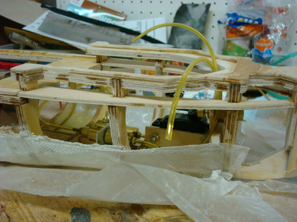

    Below, we have moved forward, where you can see the stringer/gundeck, the gun servo mounted far forward, and the two PAV-2's in the aluminum bracket that holds them. The servo puches on the MAV-3, which pushes on the two PAV-2's, making the guns fire. Not mounted yet but in this area will be the 2 accumulators and the cannons.

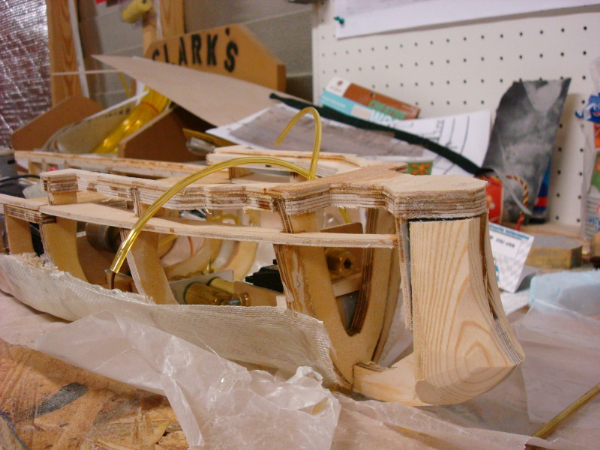

    Below, another view of this section, showing the not-quite-fully-formed bow. But it still looks COOL!

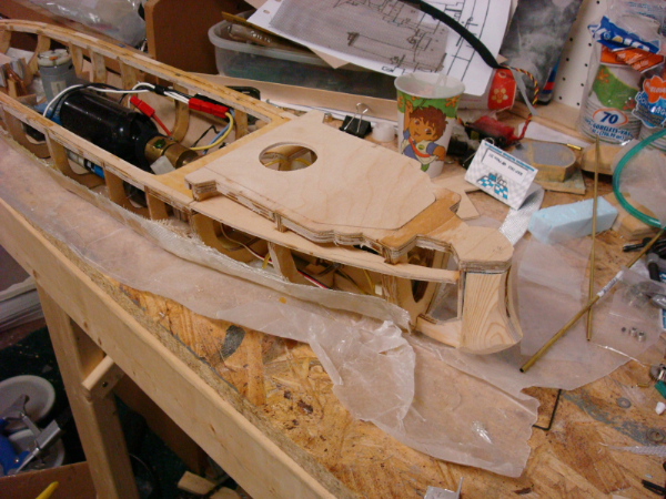

    Just because I feel like it, a pic with the forward deck on.
