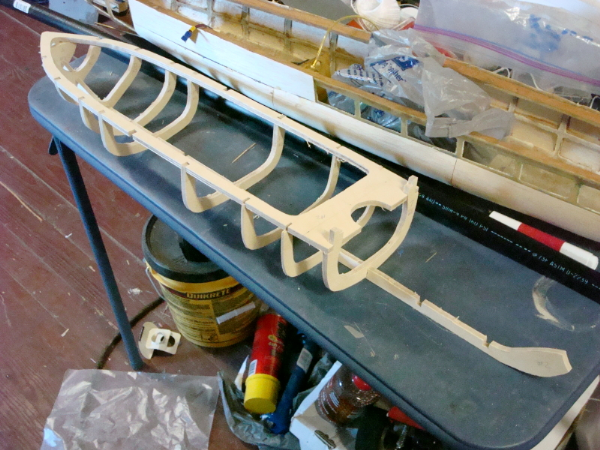

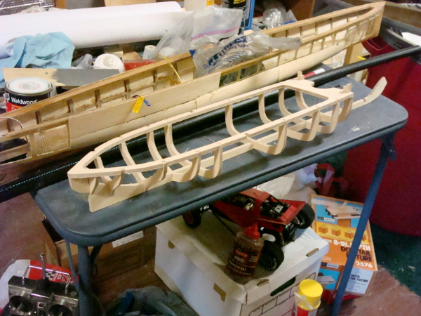

    8,298
    I got some time off from work and nursing school at the same time... so tonite, I got in the shop. I melted some wax on the Alaska mold rough spots, and got to cutting wood. After I finished cutting out Izzie's subdeck, I had long decided that my jigsaw blade was dull. So I swapped in a new one, and got to cutting some ribs out. The new blade was great, but the saw is now making wierd popping noises as I push the wood through it. Scary. I checked the blade, but nope, it's seated properly. My saw may be dying at last; it's lived a long and glorious life (>25 years of service), sawing through materials that I am certain it's not rated for. So I may be having to give it a hero's funeral soon, and buying a new saw. Anyhow, here are some pics of Izzie (Ioann Zlatoust) with almost all the ribs aft of rib 7 (inclusive), and a subdeck. It looks wierd in the first pic, just the camera angle :)

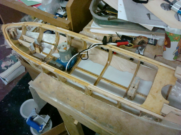

    Lastly, I got some concrete sealer put into the bilges on Evie (Evstafi). I only put in a 1/4" layer, as the instructions on the bottle say 'for deep cracks, fill the crack in multiple 1/4" layers.' Also, my test shot 1/2" deep cracked something fierce when done in one shot.
  17. BoomerBoy17
    awesome, it looks great.
  18. mike5334
    I like that thumbscrew rudder servo mount. Should make it real easy to swap servos fast.
  19. Tugboat
    8,298
    Thanks, Boomer :)
    That was the goal, Mike ;) I actually thought of it when I was outfitting the Australia (which has the first one of these that I did). My worst problem with Invincible has been rudder servoes pooping the bed (so to speak), and having a hell of a time swapping them out. Any resulting kludged servo mounts inevitably fail in short order. So, I decided to try a quick-change mount that required no tools, and standardized on Futaba servos (since I have bunches of them now). For Evstafi, I made a similar setup for the gun servo (no solenoids here in the po-boy navy :) A few pages back, there's a pic of the two PAV-2's that the gun servo actuates via a MAV-3.
    It's a pretty simple construction; I'll do a quick tutorial with pics at some point. It's also easy to scale up for a larger servo like you'd use on a BB rudder(s)...
