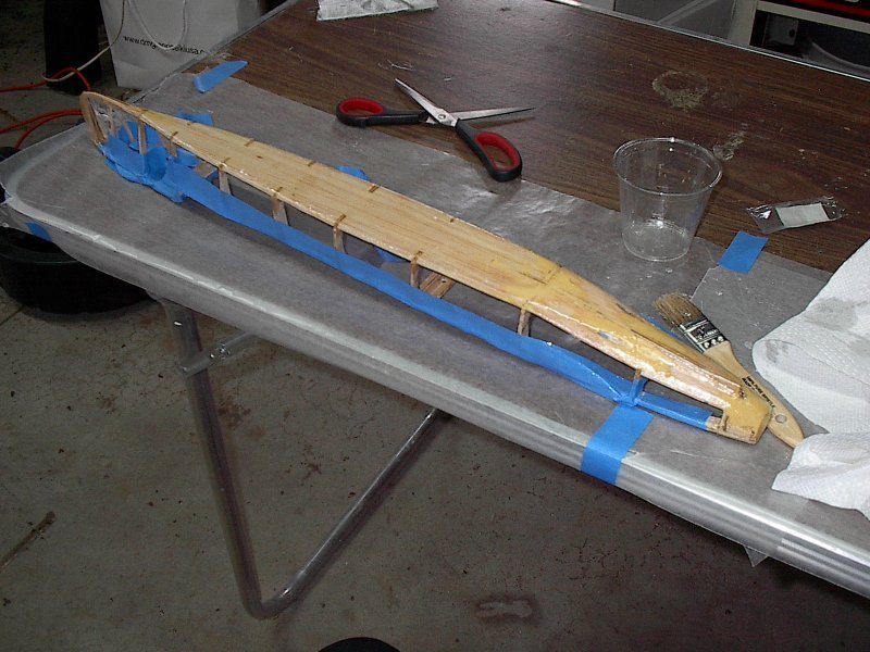

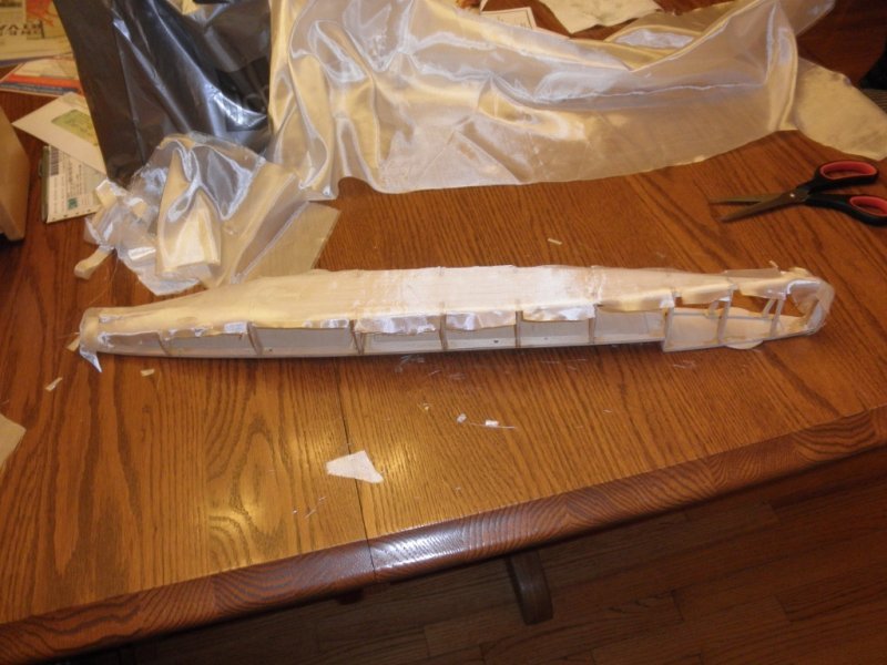

    Another view. I can't find the pics of it after it was covered with West systems. They must be on another camera.. I will try to find them.

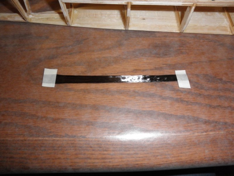

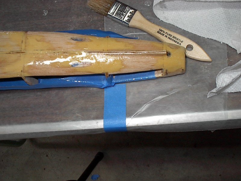

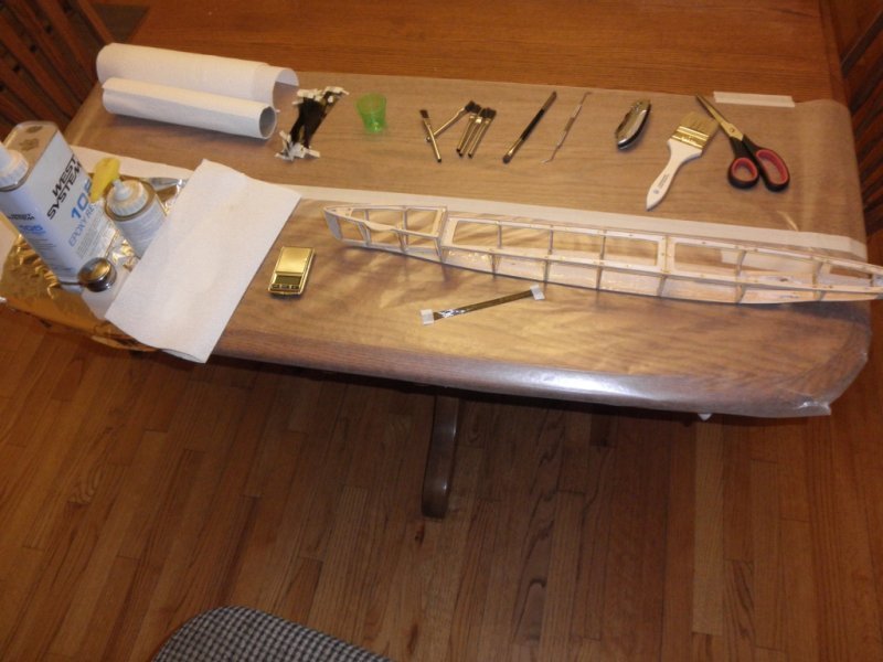

    Preparing to add some Carbon fiber "tape".
  3. Cannonman
    Apr 9, 2008
    879
    Hermitage, Tn

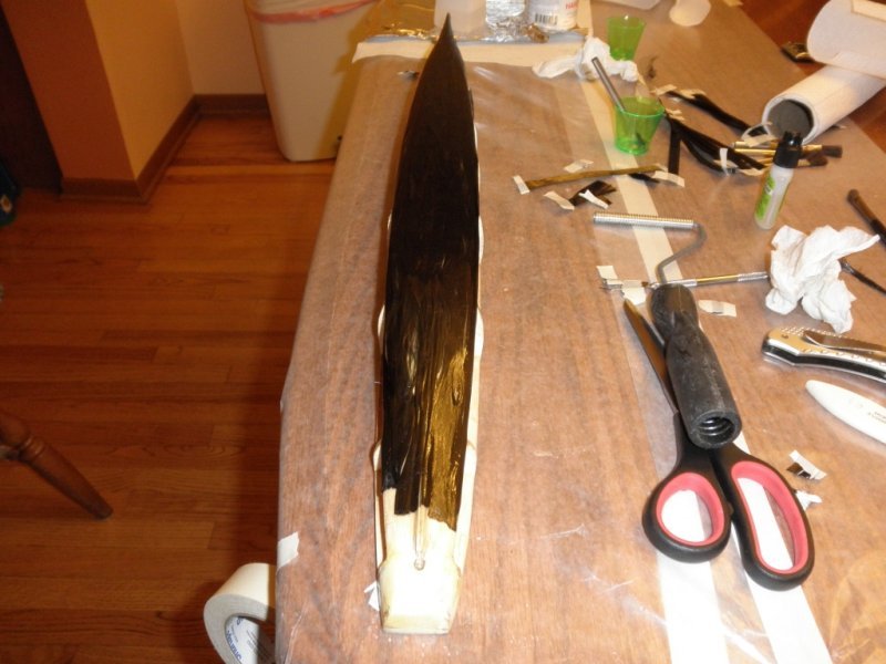

    The carbon fiber tape is actually just a bunch of strands (which can get unruly) . It comes in 12 ft pieces, so I wrapped masking tape around it in roughly 6 inch sections, then cut the masking tape in half. This left both ends with the tape on them to keep the strands together and make it easier to handle.
  4. Cannonman
    Apr 9, 2008
    879
    Hermitage, Tn

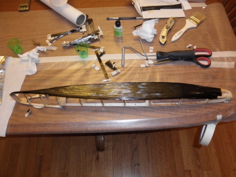

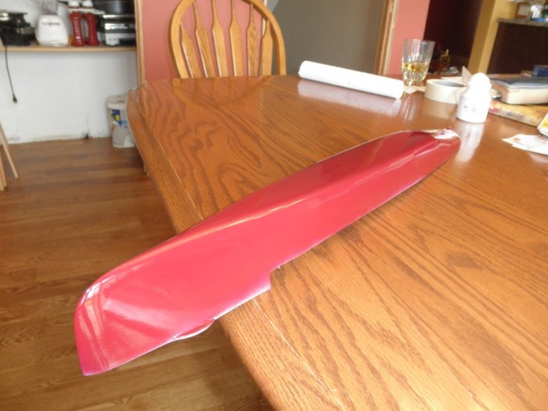

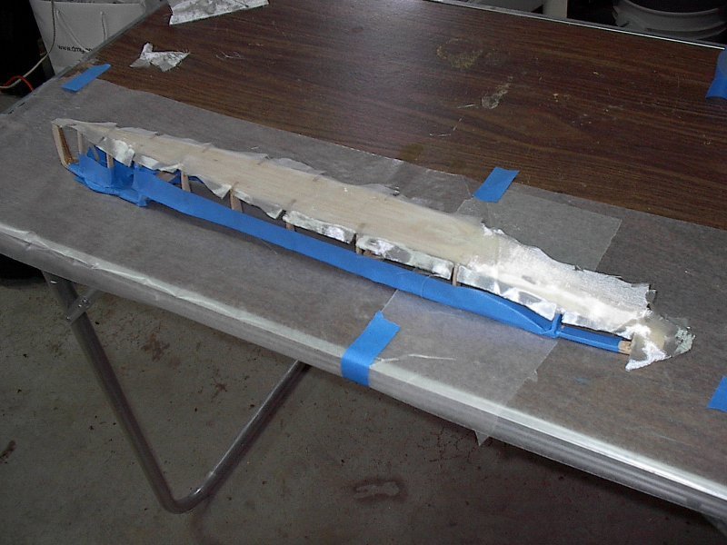

    I learned a lot during the application process.... Like this stufff really spreads out... One pice of "tape" spreads out wide enough to cover the bottom of a small destroyer once it is covered with epoxy and rolled out. Knowing how the stuff is to work with now I could do a much nicer job now.

    Another view.

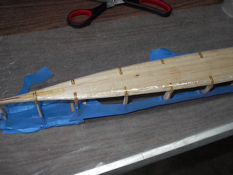

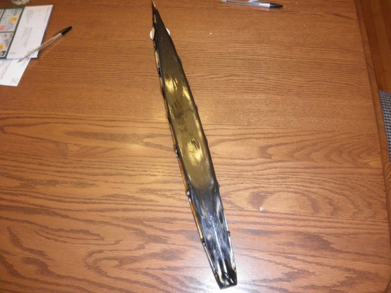

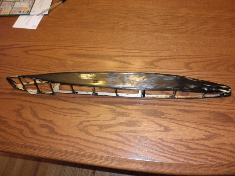

    A picture after sanding and another coat of West. I also covered the areas that didn't get done on the first go around, and did the ribs as well (NOT fun)!

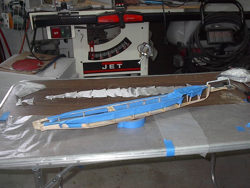

    Ah Ha!! I found the rest of my fiberglass pictures!
    First I covered everything I didn't want epoxy on.
  11. Cannonman
    Apr 9, 2008
    879
    Hermitage, Tn

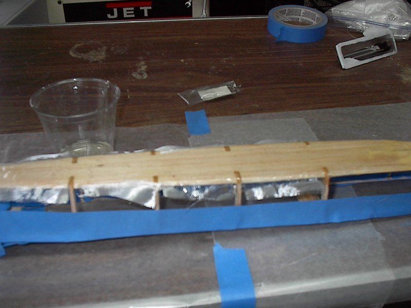

    All ready to start. I like to keep extra scissors handy in case I make a sticky mess of one pair. :crying:

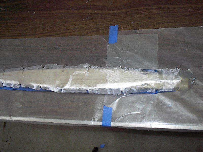

    Here it is with the cloth realigned and ready for epoxy.

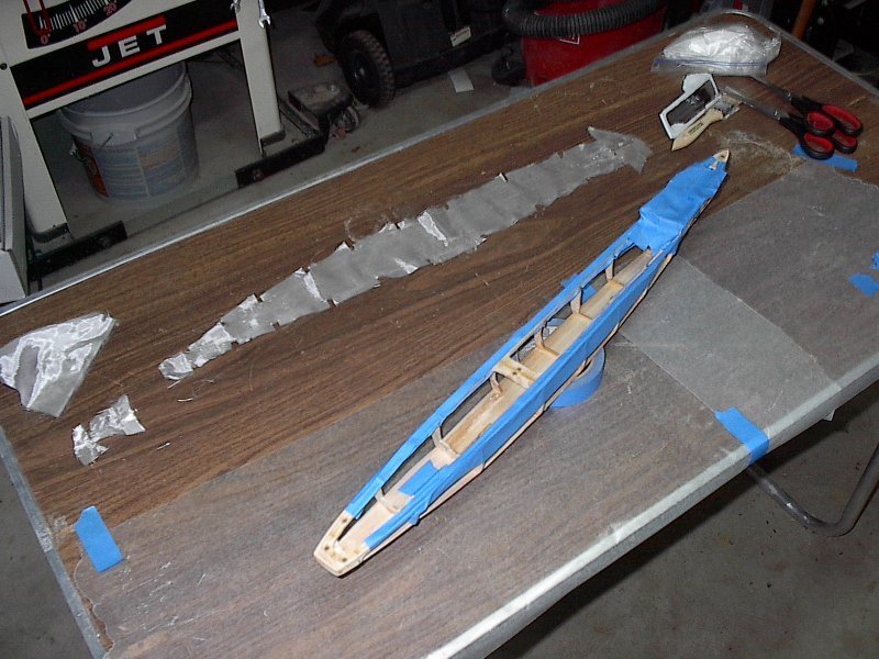

    I was a little nervous about trying to wrap the fiberglass around the base plate, between the ribs. I made sure to precut everything as accurately as possible.

    Poor focus on this one. Here I started to work the epoxy into the cloth.

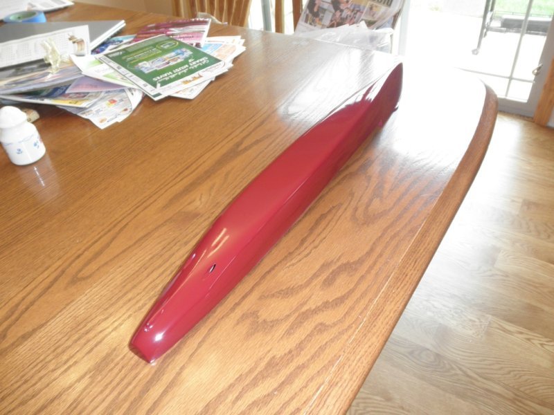

    I'm so stoked!!!! Finally some paint!!!
