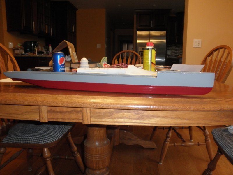

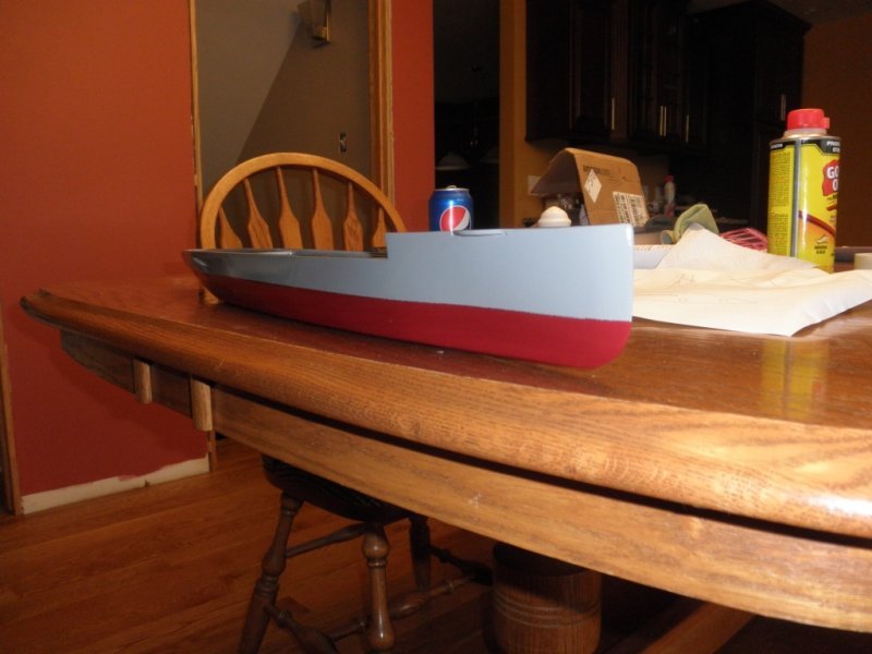

    The Grey is on now.
  4. Cannonman
    Apr 9, 2008
    879
    Hermitage, Tn
    I'm pretty happy with how it came out. I have to remind myself it's not a display model.

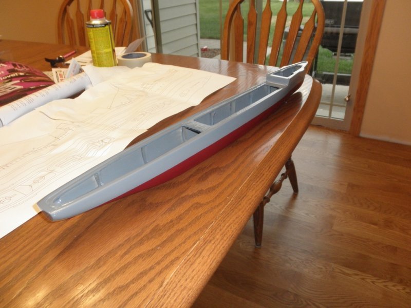

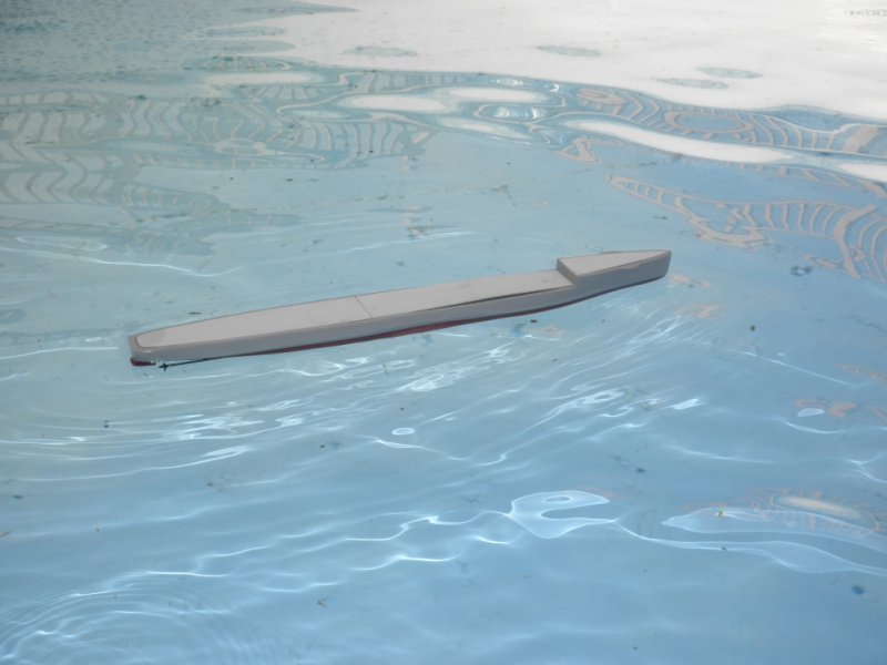

    I finally got to do a float test, with what I would consider less than promising results. The stability seems terrible at best, but I was way on the light side. I had most everything in there except the magazines, breeches, and superstructure. I was floating a little more than a quarter inch too high, mostly due to the elimination of the gyro and the fact that I thought I would need to be at 1-1/2 lbs or lighter. I was at one pound 6 ounces when I floated it. Somehow I managed to build a tiny destroyer, and wind up needing ballast..!?? Hopefully I can add some strategic ballast to improve stability and get her down to the waterline. Seems like it will take almost 1 pound of ballast to get her to the proper float level.

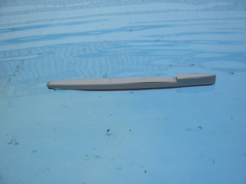

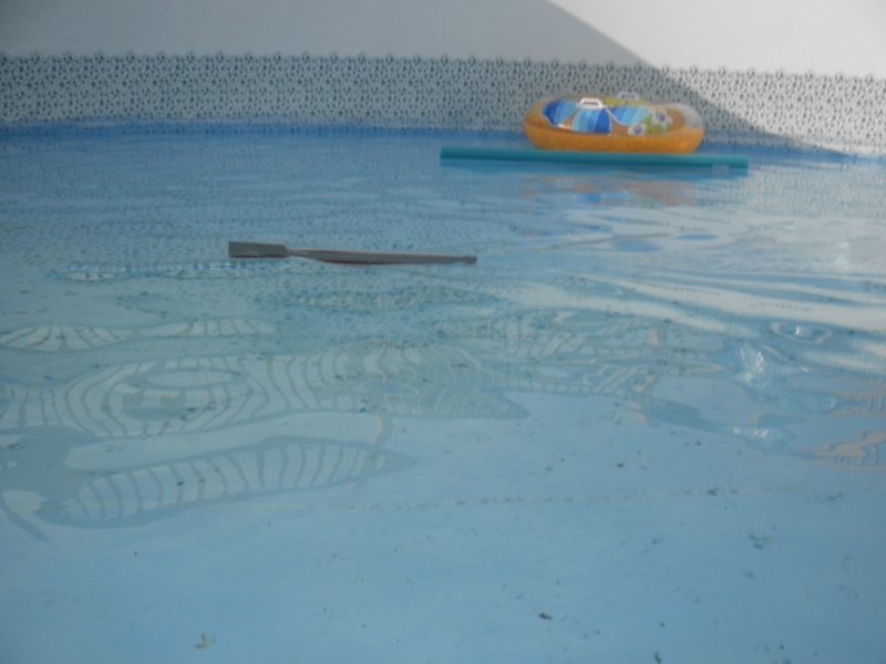

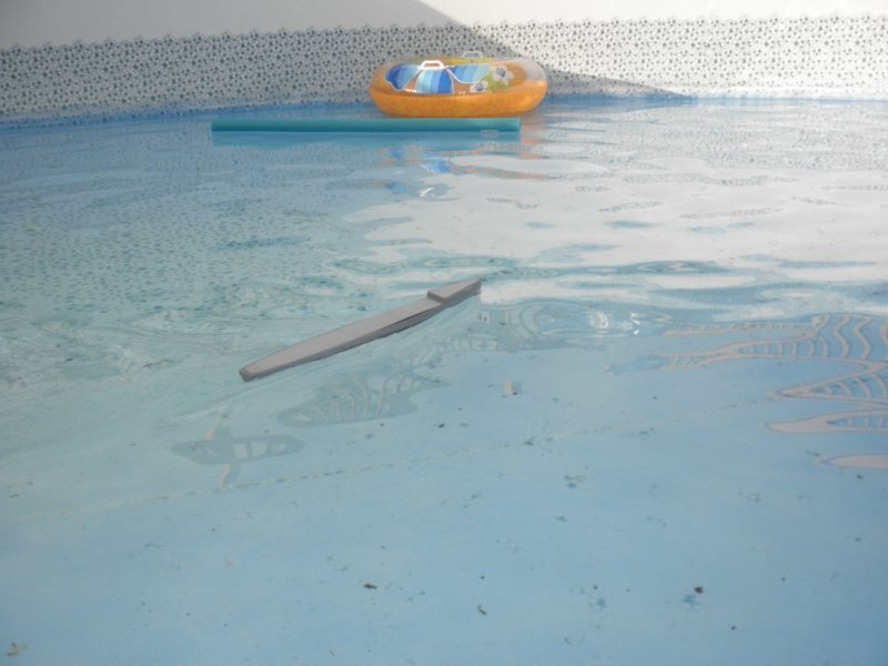

    MAIDEN VOYAGE!!!!!!!
    Woooo Hoooo!!!!! I FINALLY got a boat to float and move under it's own power!!!!! Too Cool!!!!
    I removed the unfinished torpedo because it kept rolling around, and replaced it with another battery and a couple spare gyro rotors to get her down to the waterline. I weighed her down to 2 lbs, and centered and evened out the ballast to help her float level bow to stern and without list. This caused her to float on the deeper side of the scale waterline.
    I would certainly consider it a successful run. She drove reasonably well, although I surely need to hone my boat driving skills......
    With her sitting lower in the water, stability was much better, absolutely acceptable in my opinion. Even once the super structure is on I expect it will be acceptable. Since this is my first boat, I don't really know what constitutes good maneuverability, but I suspect I will need to try to improve on the turning radius.
    There were no leaks or other major problems. The biggest noted issue was that the ESC seems to "brown out" for a second if I go from full forward to full reverse. The rudder servo also took on a touch or water and wigged out, but there was no waterproofing done on it at all yet.

    On the water:

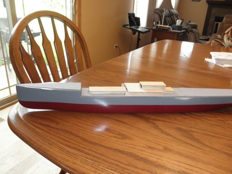

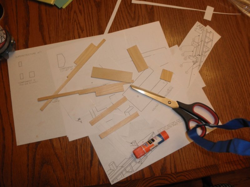

    I started on the stupidstructue today, I call it stupid because I'm sure no matter how light I make it, instability will be the end result.
  20. Cannonman
    Apr 9, 2008
    879
    Hermitage, Tn
    I figured I would try to make it from 1/16 plywood first... if that's too heavy I can try something else. I didn't get very far.... The mess I currently have in the garage is kind of work repellant :p
