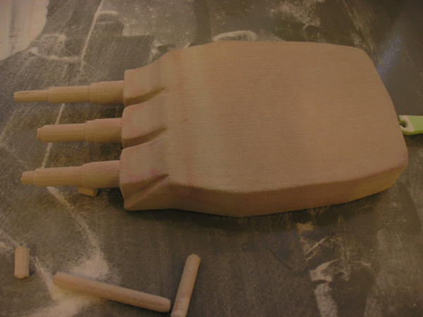

    PICTURE TIME!!
    Turret on the processing table.

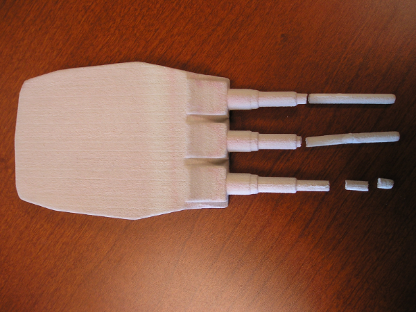

    Turret with broken barrels

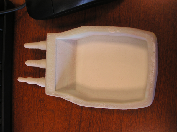

    The hollow bottom

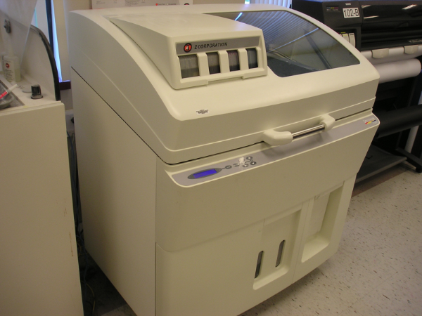

    The printer
    The model of printer I used
    I'll find out what powder was used and what glue by the weekend.

    I think it took a few hours going at 2-4 layers a minute.

    Snipehunter, yes the z510 uses powder and a binder. The barrels broke off before it was made stronger by soaking it in water and epoxying it. It's free for me for now since I'm still going to the college. Hopefully the turret I made holds up and I can do rib testing.

    Apparently my teacher felt bad that that the barrels on the turret broke, that and he had to reprint someone else's project, so he printed another turret up with twice the binder so thin parts won't break so easily. I'm guessing that the turret is 2x as strong as the origional. I really have no idea and the teacher who works the 3d printer left for the day. Now I'll have 2 turrets to test at the next battle I go to.
    He gave me a "good" idea when we were talking about the ship. He commented on how the ship would probably weigh too much if the hull was a solid piece of printer product. It wouldn't be anyway cause they probably wouldn't let me use that much of their supplies without charging me. But what about making a hull of similar shape and hollowness to the fiberglass hulls with a 3d printer? i.e. a thin skinned hull printed in pieces small enough that they could be printed all at once. [:D] That wacky idea willl have to wait for the results of the ballistic tests.

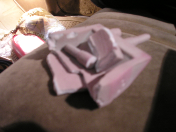

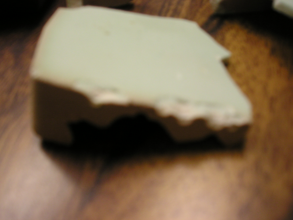

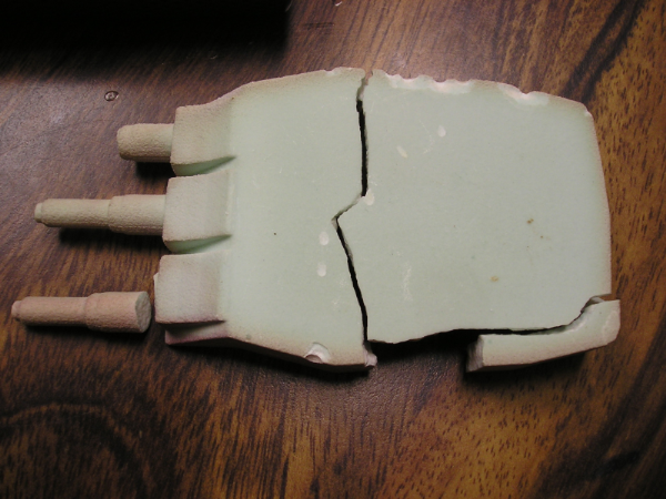

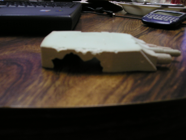

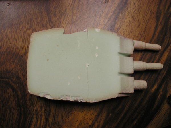

    Post test pictures of the harder turret. Remember that this turret had twice the resin as the original turret whose turrets were broke before i got it.
    Top, left, and right side views with major pieces re connected.
    Picture showing fracture lines. It took under 10 shots from under 3' away to break it as so.
    Now it's a compact turret.
    Rob from NYBG suggested a layer or two of fiberglass on the turret might have made it battle worthy.
  17. donanton
    Not good for battling, but would be good for making molds.
  18. donanton
    Any suggestions?
