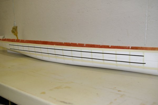

  10. Tugboat
    RE: USS Alaska (Treaty/fast-gun) At least she's got a big long armor belt, so you get a nice stringer.

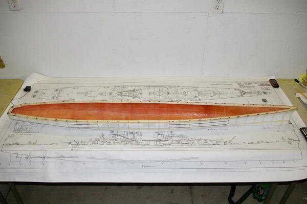

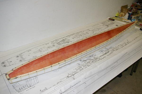

    RE: USS Alaska (Treaty/fast-gun) Mikey,
    What are the dark areas on the subdeck?
  12. absolutek
    RE: USS Alaska (Treaty/fast-gun) Marks closest to the fibreglass look like marker, the smaller lines on the inside look like relief cuts possibly.
    RE: USS Alaska (Treaty/fast-gun) Yes.
    Small lines are relief cuts.
    Black marker areas are for marking out where I want to use super-glue to hold the wood in place, while the epoxy cures.
    So I have epoxy on most of the wooden strip, with small areas of super-glue in between.

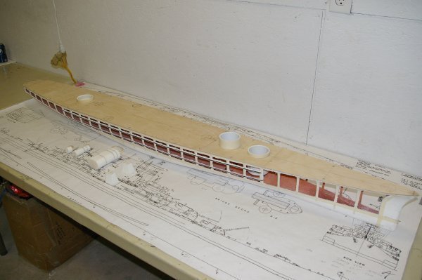

    RE: USS Alaska (Treaty/fast-gun) I got all of the windows cut out, and the deck on my USS Alaska this weekend.
    I also measured and marked off the placement for my rudder, shafts, and main
    turrets. The barbettes are mounted.
    I will try to post some new photos later.
