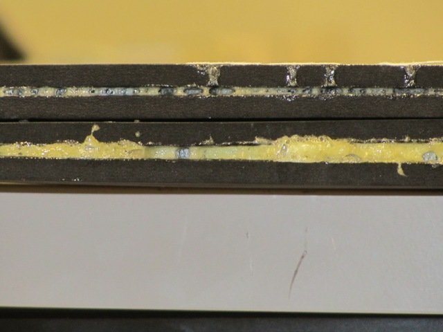

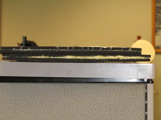

    I tried two different glues, both may seem over kill.
    Gorilla glue and contact cement.the gorilla glue has one issue that I found. It expands and it is strong when it does.
    These are the same pieces. I had 2 packages of 8 1/2 by 14 paper on top and it still lifted the sheets apart.
    I used Lepages gel contact cement, the same stuff I use for sheeting and so far so good. It didn't eat or damage the foam in any way and it has been 1 1/2 hours and the pieces are held together very strongly.

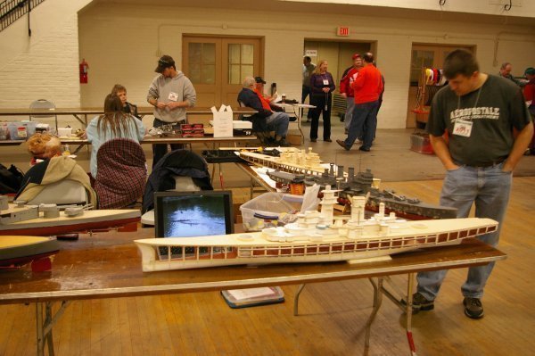

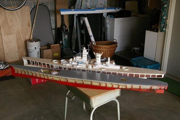

    Mikey's USS Alaska, and Dave's USS Alaska at the build-session in Red Lion.
    It was love at first sight.

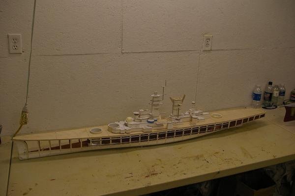

    My USS Alaska after returning home from the road trip out to Pa.
    MIkey
