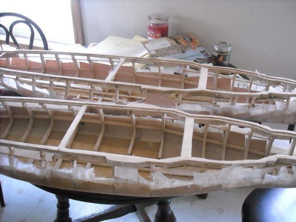

    Thats up to Gordon Gregson. He gets the first one , the other 2 are being cut out to go one the build board.
    Buddy

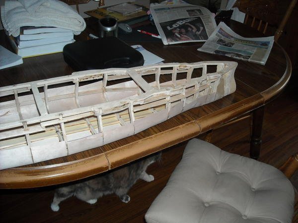

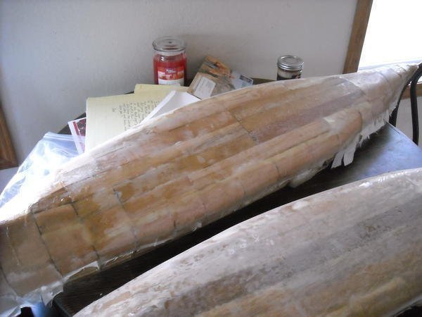

  7. Anachronus
    What did you plank the bottoms with, Buddy? NICE looking hulls :)

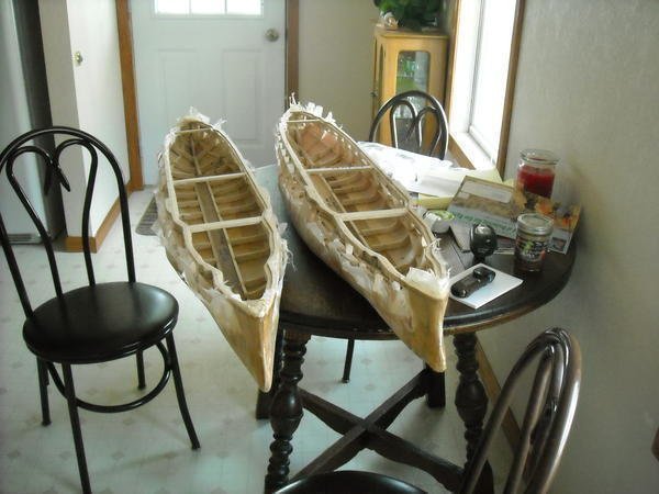

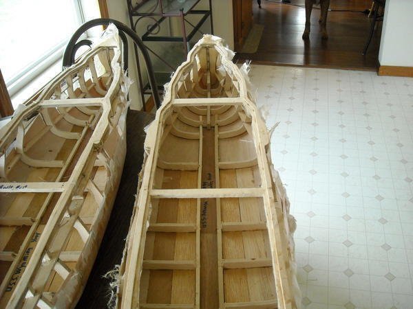

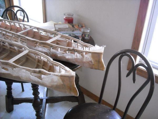

  10. Buddy
    Buddy Active Member
    Jan 26, 2007
    632
    Newark Ohio
    Well thank you guys, the one is the USS Arkansas and the other is for Brandon , the USS Wyoming. Both are planked from the center keel out with 1/16 plywood to just about the outer edge and then on the curves the are planked with 1/64 3 ply plywood. I then use 3 layers of 2 oz tight wove fiberglass cloth on the hard area below to jsut under the curve, from there I use 2 layers of 3 oz cloth across the flat bottom. The bow and stern get 3 to 4 layers of 2 oz cloth. I use marine grade resin on the cloth and then when it is lightly sanded I use 3 coats of marine grade ployurathane to make a good seal. All the insides will get pretty much the same treatment. Hope you enjoyed the pics, I have the thrid almost ready to fiberglass. It has been a lot of fun to build these ships, they are very unique and awsome!

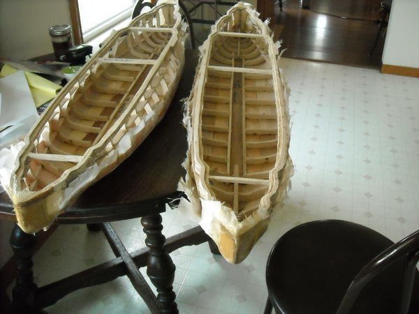

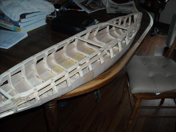

    Here is some pics of the Wyoming 2

    Thi sis the third ship being built going to Allen. She is ready for the fiberglass.
