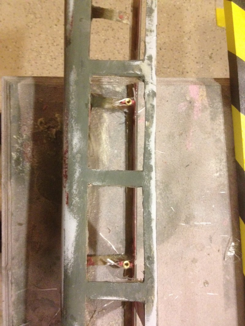

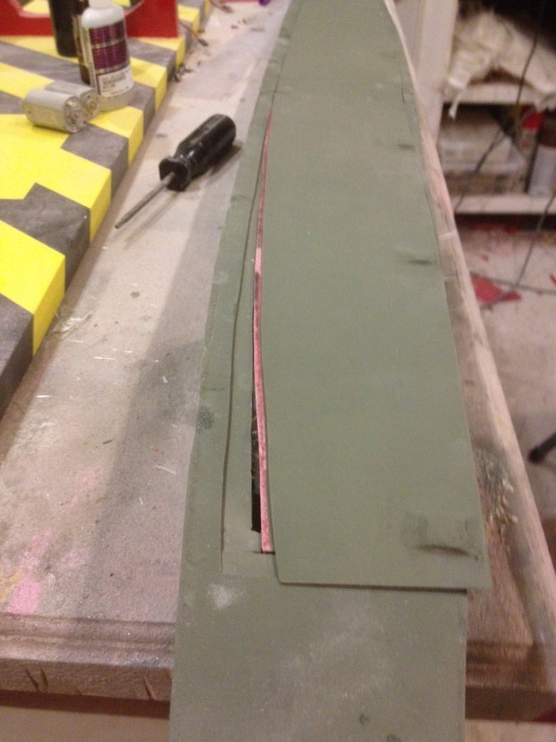

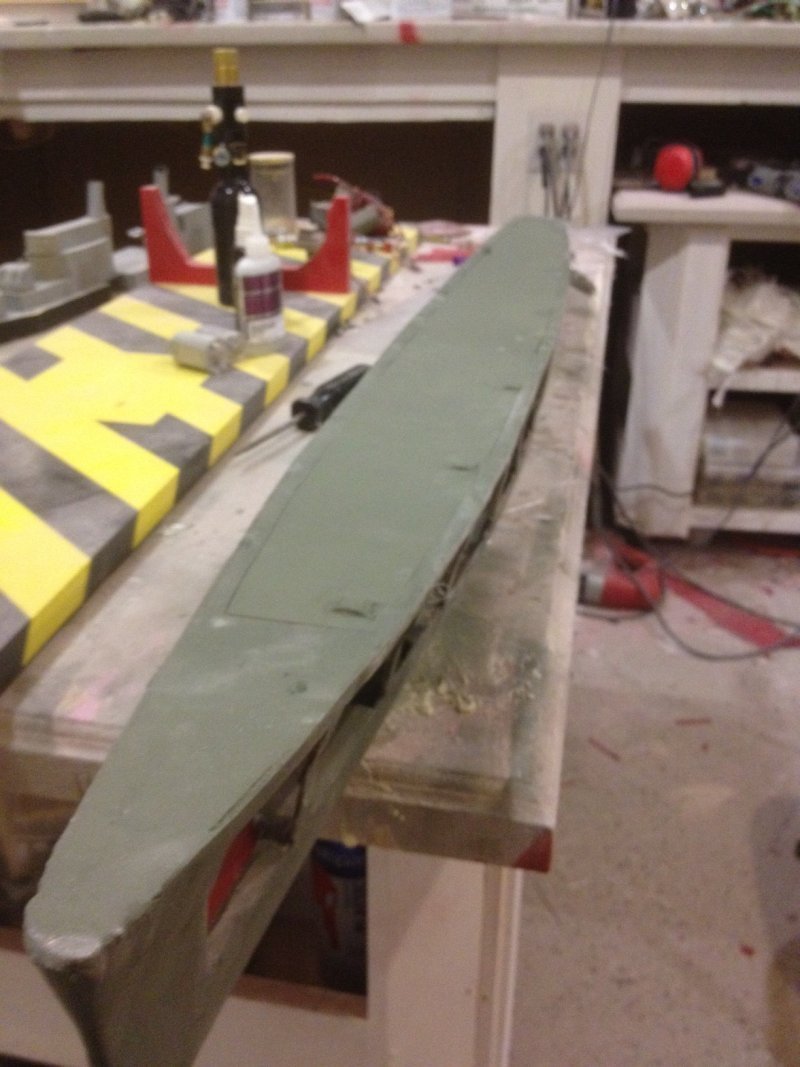

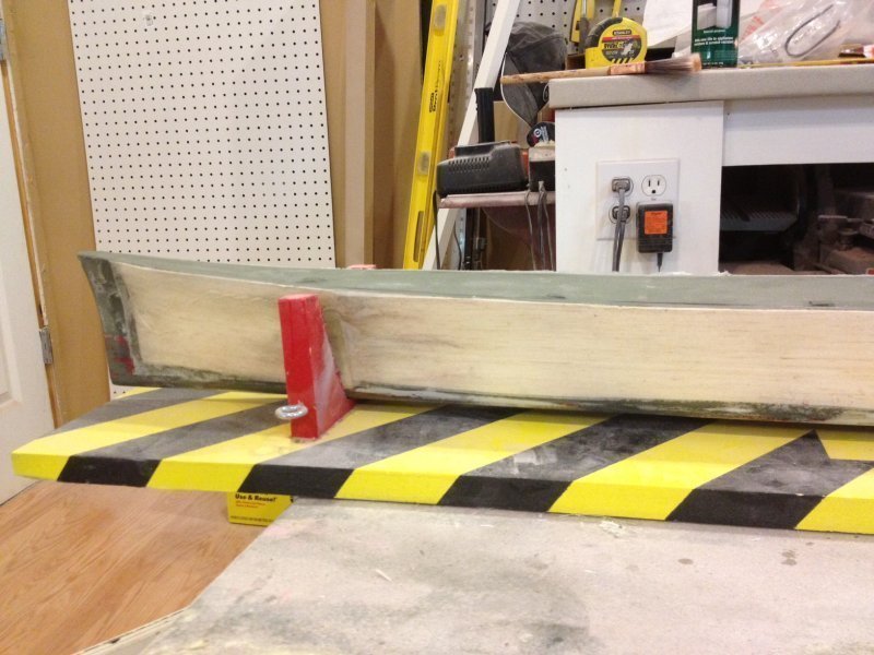

    This is a shot of the current state of the boat. Decks are on and primed.
    In this shot you can see how the three decks work together for a water tight seal. The subdeck is constructed as any normal deck, I use two pieces of 1/32 decking to set the level relative to the top of the hull. Then the second deck is cut (using scissors) so that one side has a 1/4 inch side and the other is 1/2 inch. The top deck is then cut the opposite, this way the one side has a "lip" (you can see it in the picture as the red lip. The other side is held on by the magnets, which will get hidden by deck superstructure.
    The deck installed on the ship, note the tight tolerance.

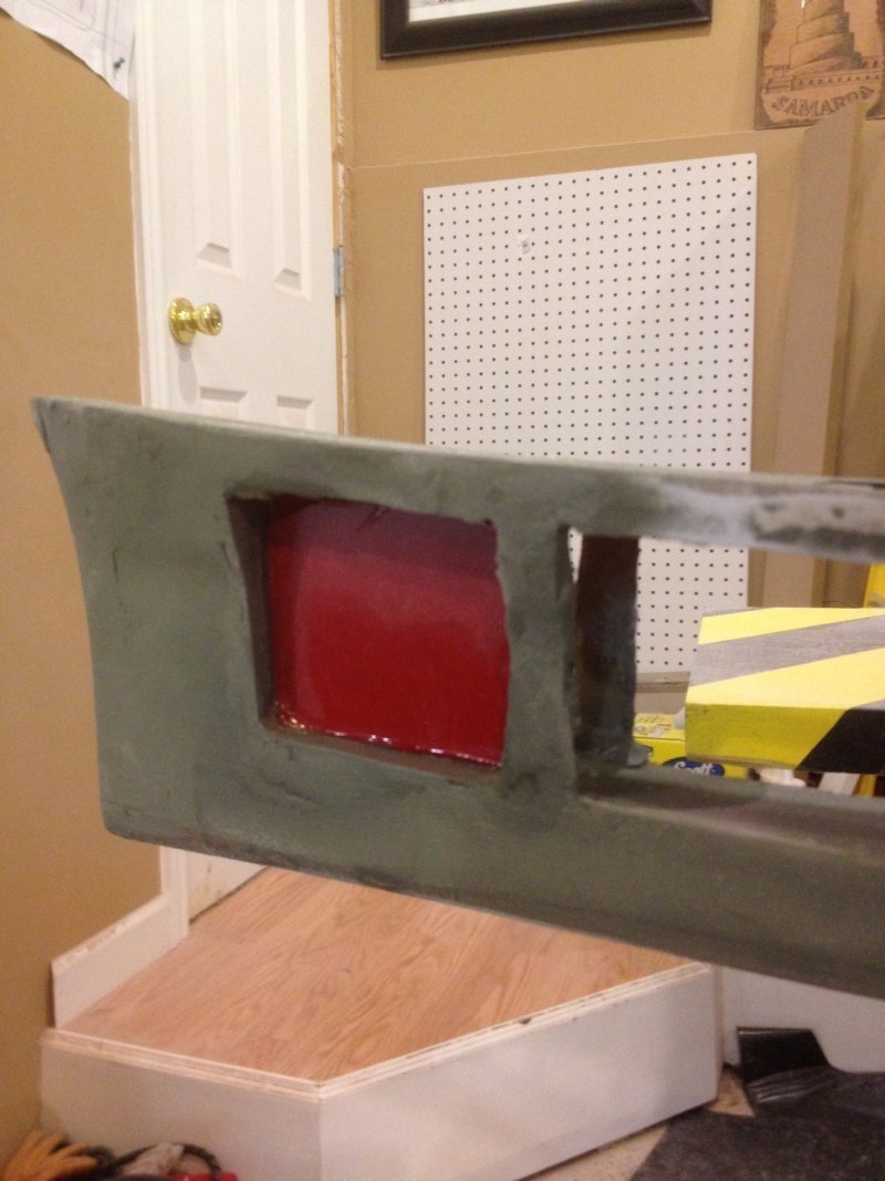

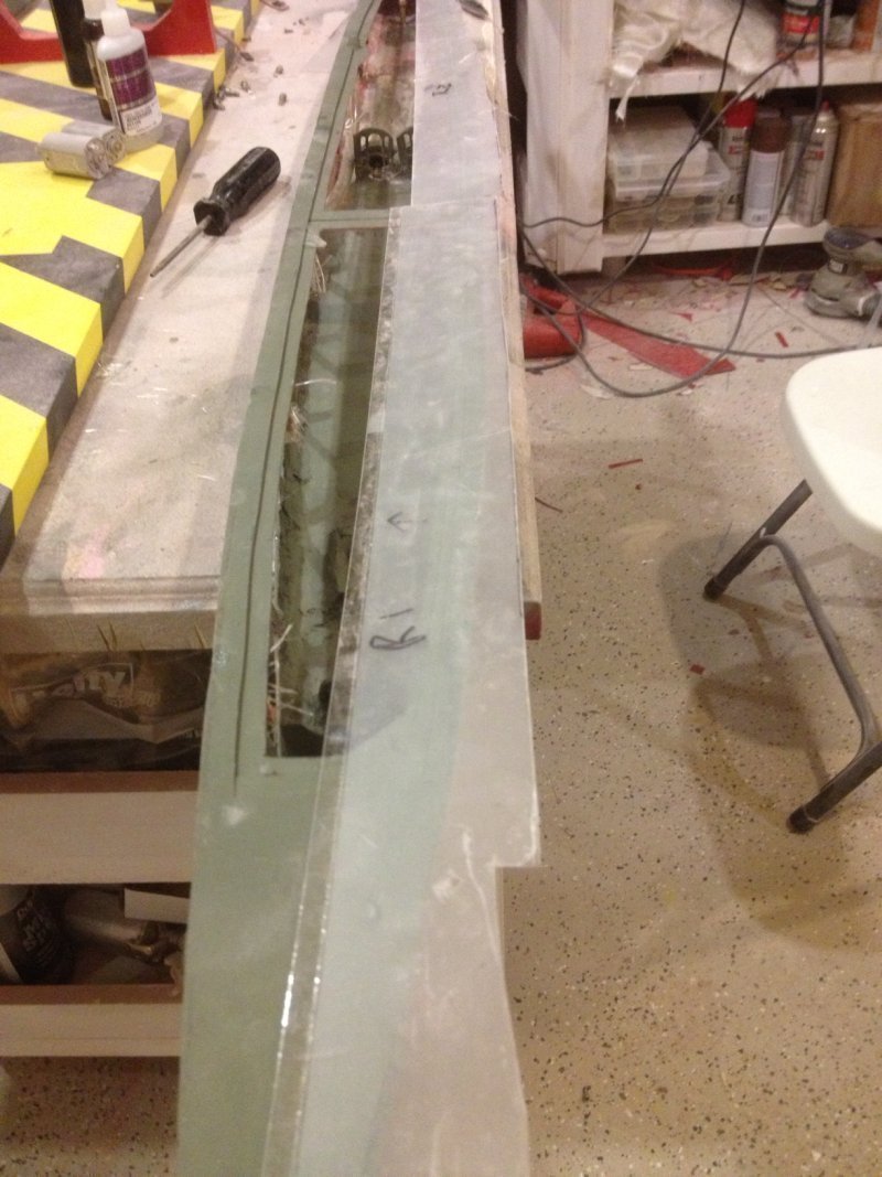

    Blast shield made out of lightweight lexan, the cloudy look is from the protective covering. This will be removed later.
    Had to think about this for a long time, how to attach the shield to the hull so that the mounting points will not get shot off and how to keep the bb's from going through the ship. Finally settled on brass inserts and 4/40 ss screws that are fiber glassed into the subdeck and cap rail. There is one every other rib to keep down on weight. I will drill through the lexan and leave a little "play" so that the energy from the bb can be absorbed, at the bottom of the shield I will place a few blocks to keep the bb from going underneath. Still have to clean it up from this picture, wanted to show a shot of the process.
    In the extreme bow I put a 1/32 fiberglass board that is epoxied to prevent through and through shots. The blast shield will also cover this area, but more is good in this case.

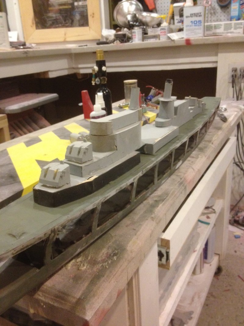

    Installed the blast shields, just had to add two more mounting points where the material overlapped.
    Now I need to wait for the batteries to get here on Friday so I can layout the internals and get the boat balanced. I did a preliminary weighing and I look to be around 8 pounds. That gives me 1 pound to play with, better if I can keep it around 8.5.

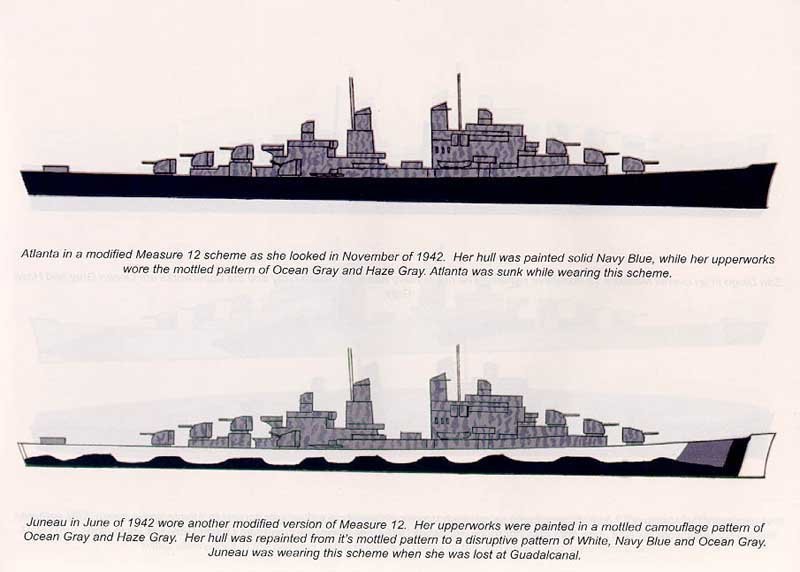

    As I am watching weight on this build, the inside is done except for hold downs for the internals. Applied silkspan and sheeted both sides of the hull, will paint tomorrow night in the dark blue color. Superstructure will be the cool mottled look when she was lost.
