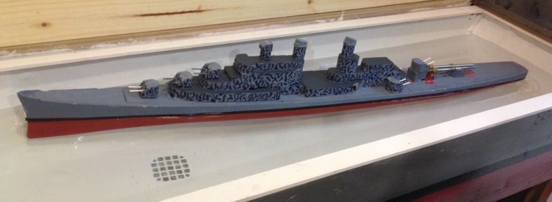

    Water line time in the test tank. Still a few items to finish.
    Will you have time to run her around the pond for dynamic stability tests?

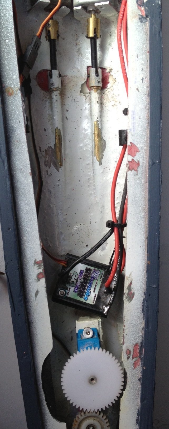

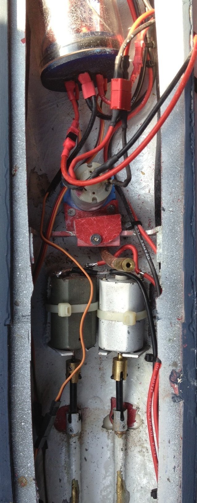

    Had to move the ESC as there was interference with the radio. Insides are looking a little rough at this point...
    Switched a motor, and added a stronger zip tie.

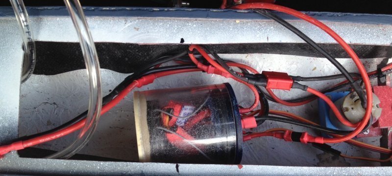

    WTC (water tight cylinder) is done, two HK switches and a castle creations BEC.
