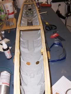

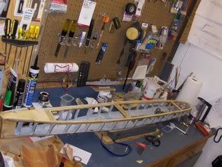

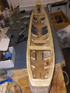

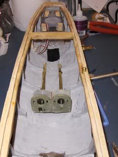

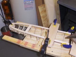

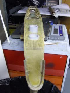

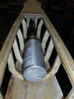

    The Build

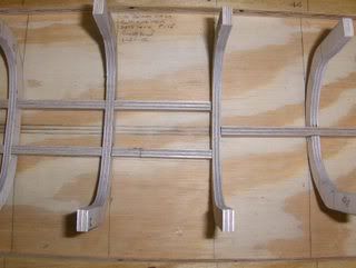

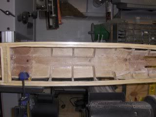

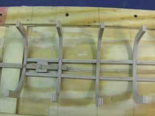

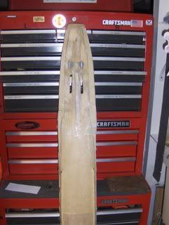

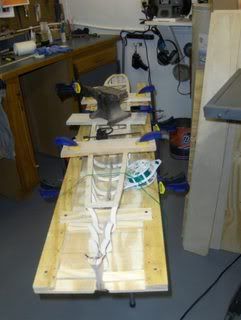

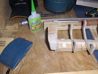

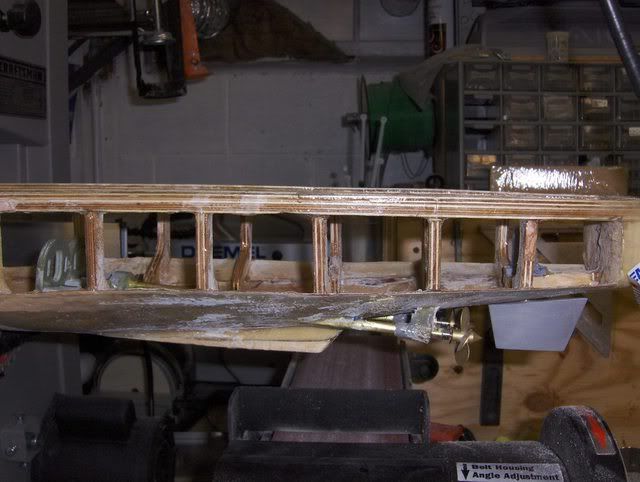

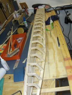

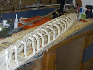

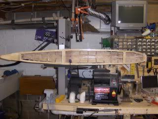

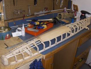

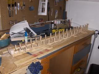

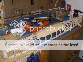

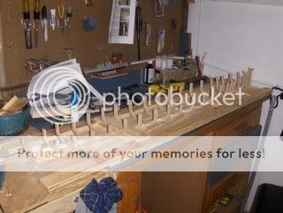

    Laying the keel

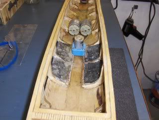

    Ribs anyone
    [[​IMG]
    [[​IMG]

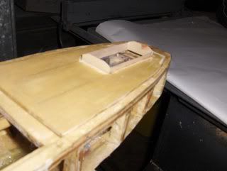

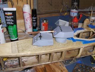

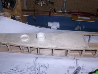

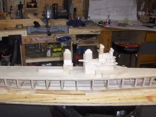

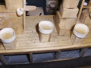

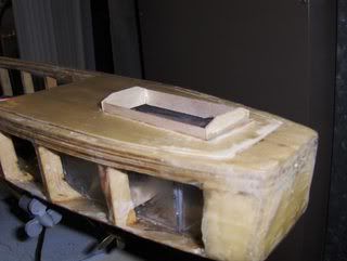

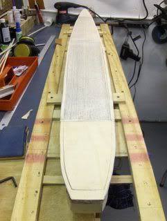

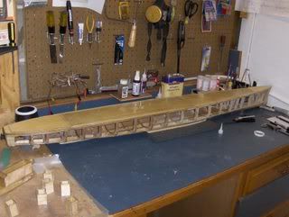

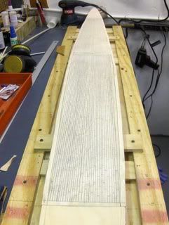

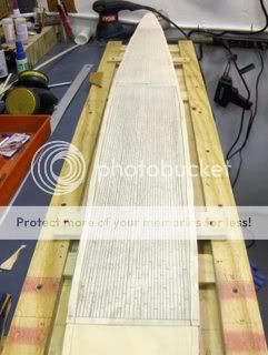

    Decking
    [[​IMG]
    Sheeting

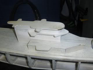

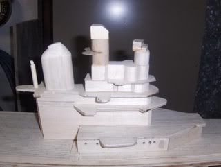

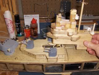

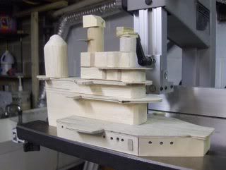

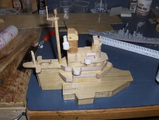

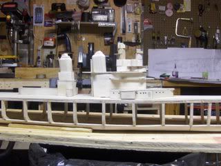

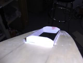

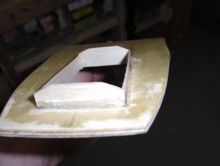

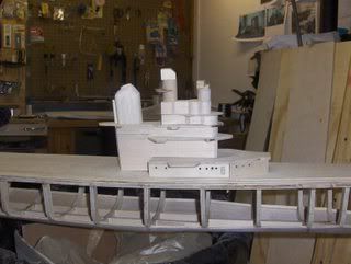

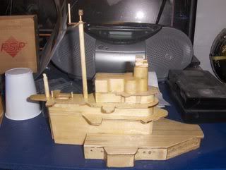

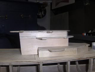

    Super Structure

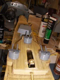

    Barbette
    Seaplane Hanger

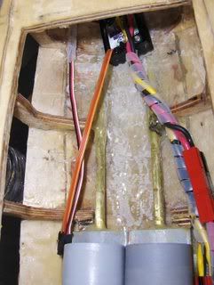

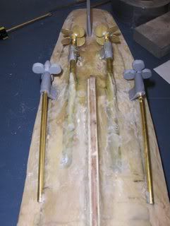

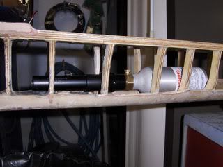

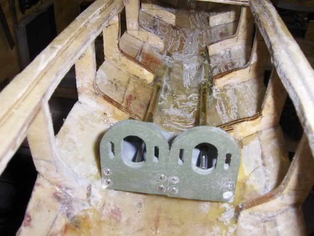

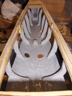

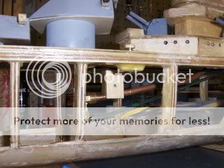

    Inner workings
    Water Channels

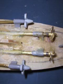

    Bilge Pump
    Rudder

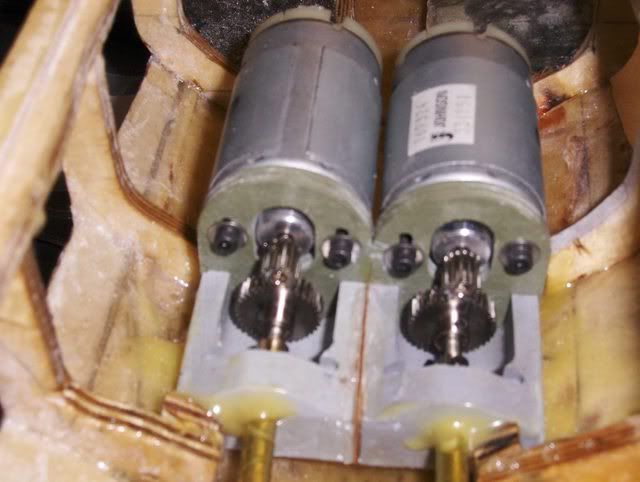

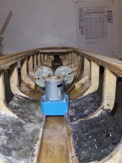

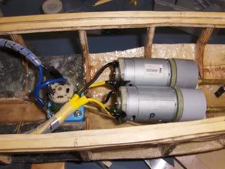

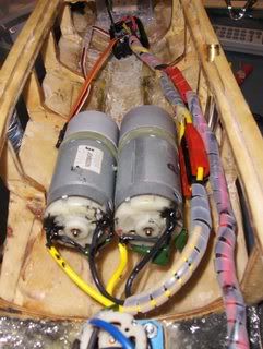

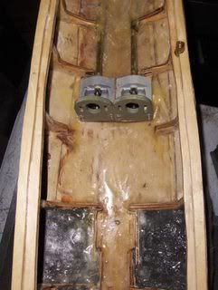

    Motor Mounts
    Stuffing Tubes

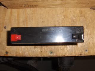

    Powder Magazine

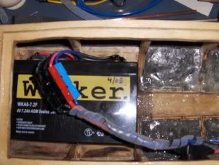

    Boiler
    Electrical

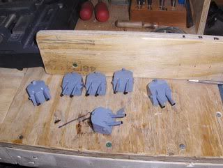

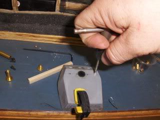

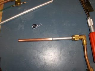

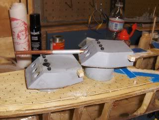

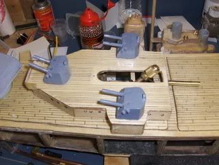

    Armament:
    9 x 8"/55 guns (203 m),in three triple turrets, one superfiring forward 15deg , two aft,
    12 x 5-inch (127 mm) L/38, in six twin mounts, one forward, one aft, two on each side
    48 x 40-mm L/56
    24 x 20 mm

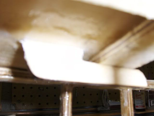

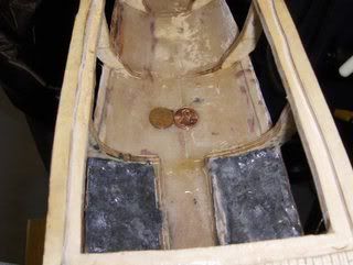

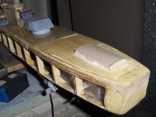

    Above you will see two pennies glassed in to the hull one 1943 Wheat Back for the original Commissioned date: 30 June 1943 and one 2008 for the Models Commissioned date

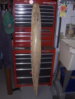

    I'm finally on the last leg striped her down for outfitting and New coat of paint
    Top Side

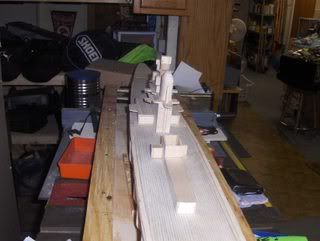

  4. Powder Monkey
    A little help from my friend
  5. crzyhawk
    Looks like she's coming together pretty well.
  6. Powder Monkey

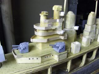

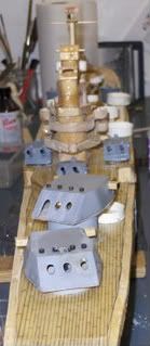

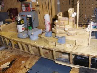

    Yes it is falling in place [^] we had a few stumbling blocks but hey that’s life. Now that I have the correct Hardener life is a lot less sticky and after today’s build session she should be right on cores[:D]

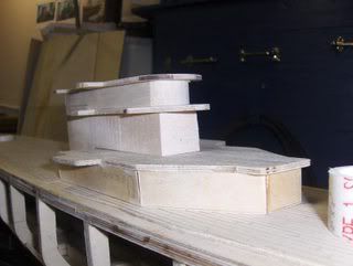

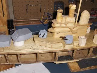

    It's looking good, Monk... I really like your superstructure :)
  8. Powder Monkey

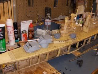

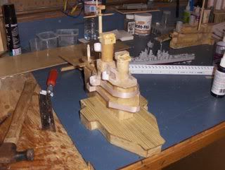

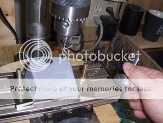

    Thanks tug I’m struggling to balance my mind I like details but weight is an issue I only have 12 lb to play with and as of right now the super and all the surrounding parts(not shown) eat 2 of that ouch I'm going to give my dremel a work out on this project [;)]

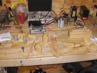

  9. Powder Monkey

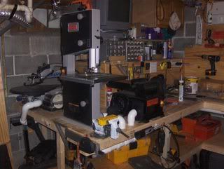

    [:0] my Dremel [xx(] craped the bed [B)] when you need it most go figure [V]

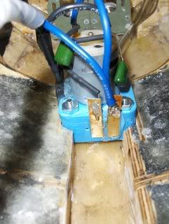

  10. Tugboat
    I've had that happen... the poopy variable resistor they use for speed control on that model I had burned up... What broke on yours?
  11. Powder Monkey
    [:(!] I lucked out the Dam Rubber sleeve at a whooping $1.00 however it leaves me down for three days while I'm waiting for the part but I ordered 2 of them and a set of brushes it is an old Girl a 395 so I guess I'm lucky to have gone this long with out it failing back when things where made better. oh well it gives me time to work on my cannons I suppose [:p]

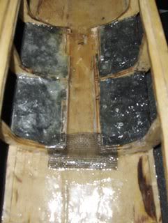

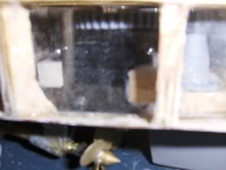

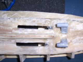

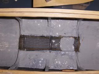

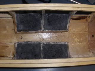

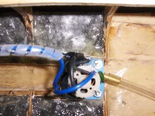

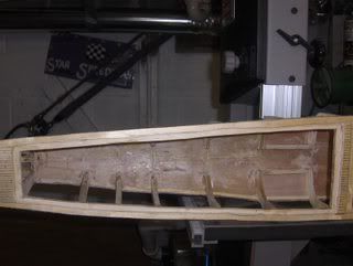

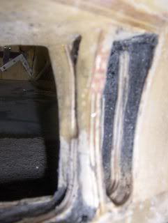

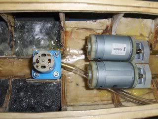

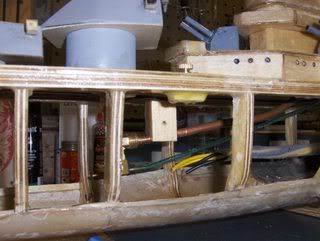

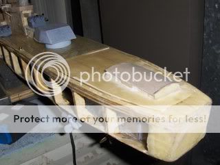

    Hey it is very nice! What is the black stuff in the middle?
  14. Powder Monkey
    [:D] Thanks Buddy

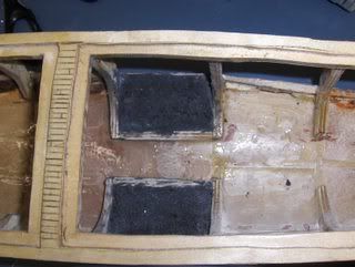

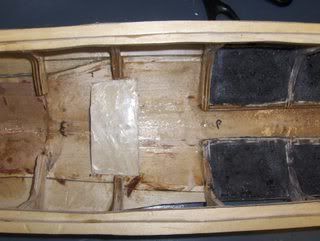

    The Black stuff besides being impossible to get off my fingers is TOUCH "NFOAM it is an exterior filler adhesive made by Convenience products seamed to be the perfect thing being made for wet areas. that should keep the water out from behind my water channel all though once I start cutting to fit all my stuff in there wasn’t much water channel left [:eek:)] just glassing over the middle but the bow I only put resin over it seeing as it was such a small area [^]

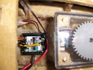

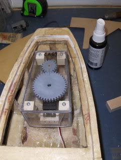

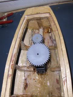

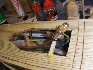

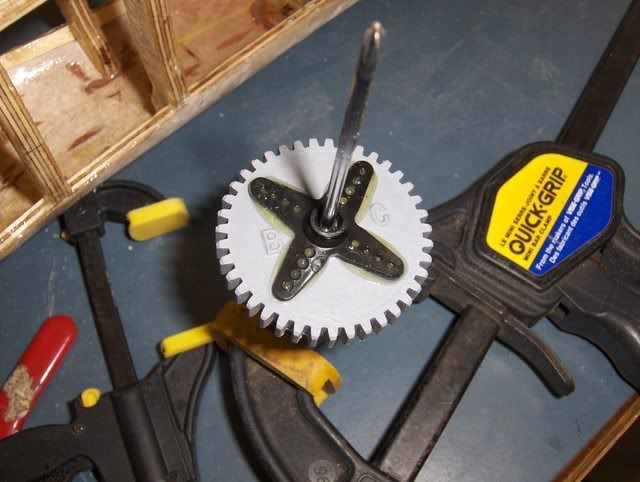

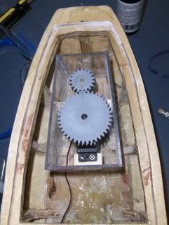

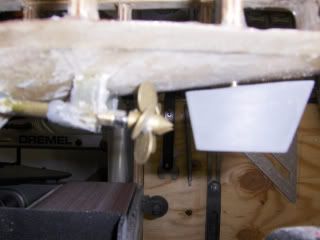

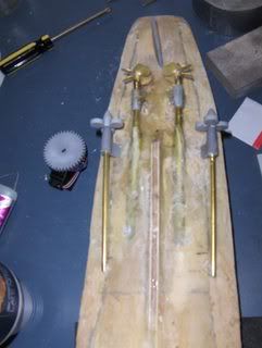

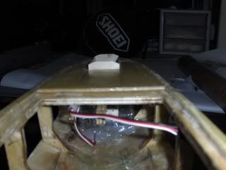

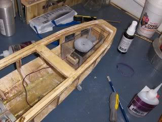

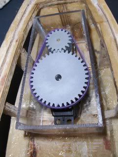

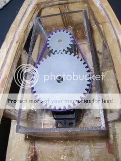

    Hey powder did you water proof your rudder servo? And how did you secure it in place?
  18. Powder Monkey
    LOL no I don’t plan on it getting wet....[:D]
    I plan on it getting soaked I’m actually working on that as we speak just took a break because to tell you the truth I’m not getting any brain storms for a secure system [|)] got any ideas ?
  19. EricMA
    EricMA Member
    Jan 30, 2008
    121
    A few but I haven't tried any of them. I'm leaning to building a box around the rudder post and servo using the bottom of the boat as the box bottom. I was thinking of putting two ribs across the inside of the box at a hieght that the servo could rest between them and I would secure the servo to them. if you put an o-ring on the rudder shaft between the rudder post and the gear it should not leak much or not leak at all. want to test it in your ship and let me know if it works before i try it? :)
  20. Powder Monkey
    Great minds think a like I am half way done with it when you come over we can load my ship up with your special weight and see how it works [;)]
