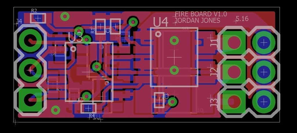

    So I got a bit distracted and ended up designing dual solenoid firing boards. They should withstand 40volts (of course I am not going to ever push it that hard) and be able to control 3Amps per channel. I aimed it at being compact while still being isolated from the receiver. The current board is .9" by .4" and completely isolated from the receiver. I am going to send them out to fab soon and do some destructive testing to find the true limits before I stick it into my ship of course.
    The code itself will basically fire one side when sent one direction from the tx, and then the other when it detects the other side. The dead zone in the middle is pretty large so I don't accidentally set it off.[​IMG]

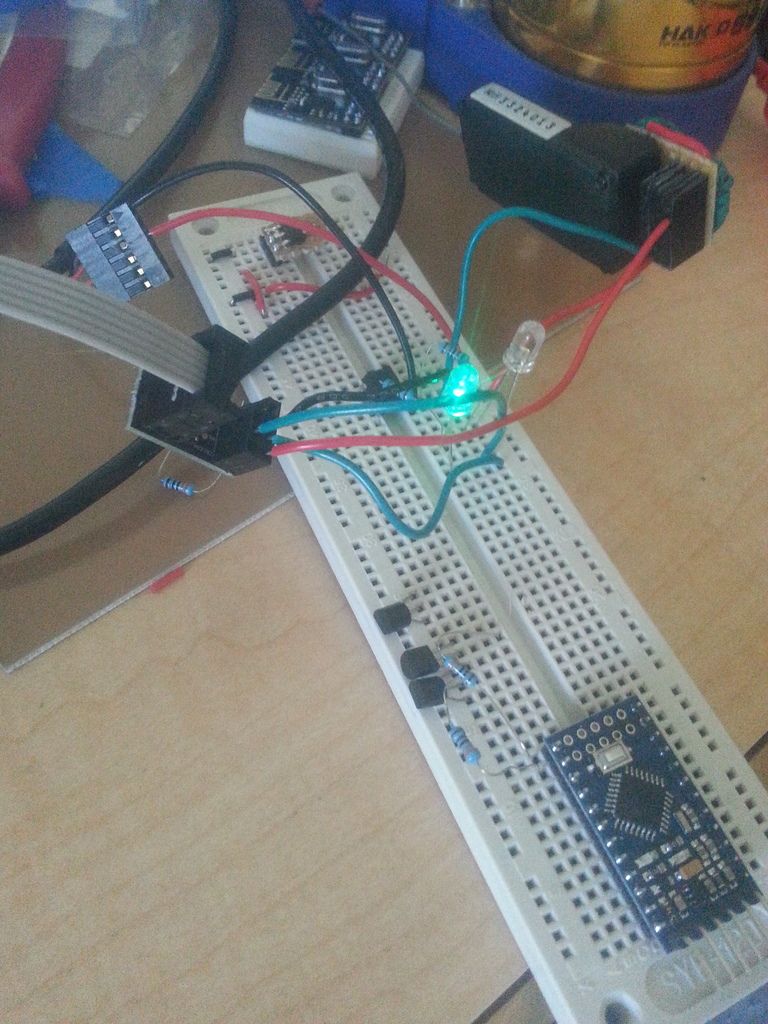

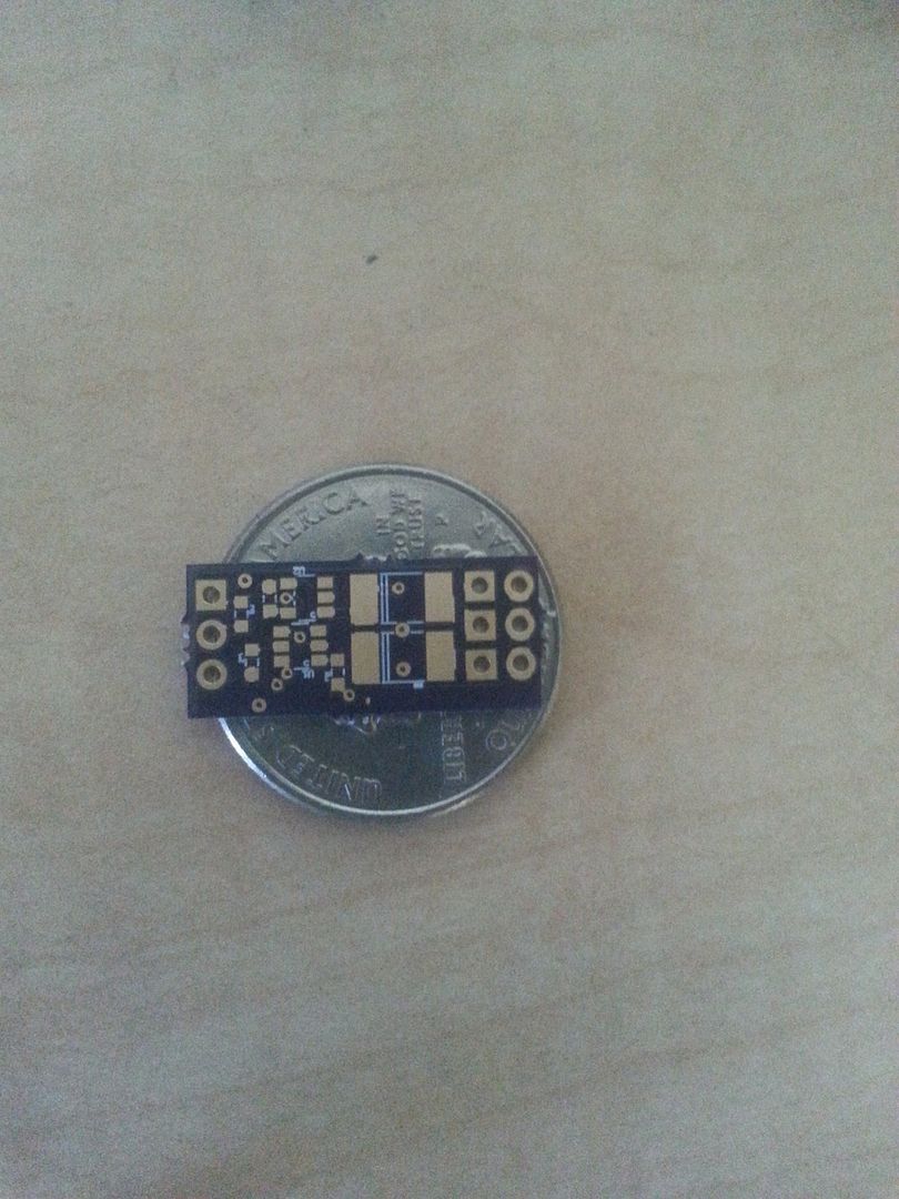

    So the first prototypes of my firing control boards have come in, please excuse the picture quality, my phone's camera is about as scratched as they come. They seem to function well. I still have to run destructive testing to ensure that they play nice with multiple solenoids. The second image is actually of the test board for the MCUs but it serves as a proof of concept for the board itself. I just got excited so I thought I would share the progress. If they work I will be overjoyed because they are sooo small but still dual firing.
