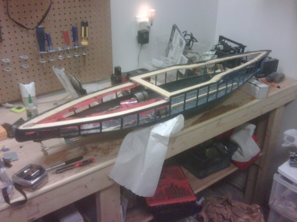

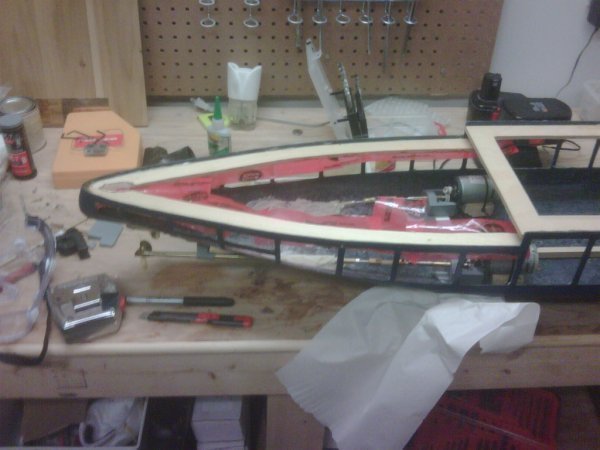

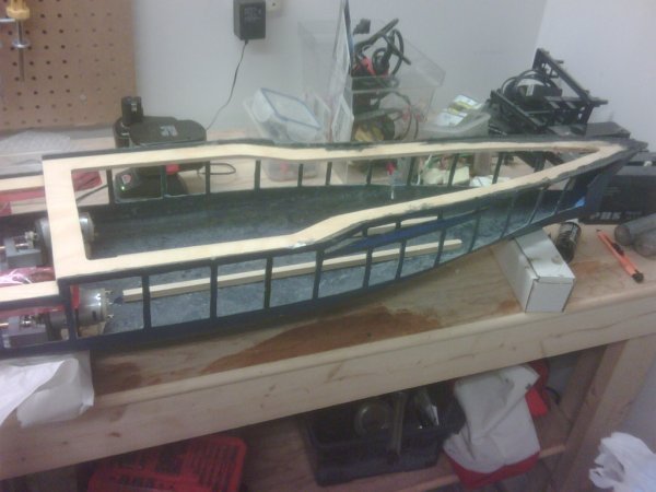

    Well the subdeck was installed. The rear subdeck was done Saturday. This morning say the front subdeck go in. Now it is time to kick this build into high gear.
    Excellent Captain. Excellent.
  15. bb26
    Here are some pics of the subdeck. I have started tool dipping some servos so I can start making my throttle.
    Looking really good Paul.
  17. bb26
    Thanks Curt. I think next thing will be to pre-cut some hatches and then resin on the main deck. Once done then I can start working the internals. Servos have been tool dipped.
