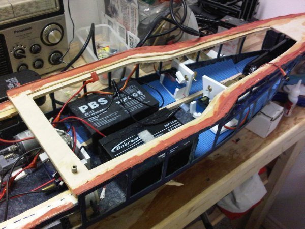

    More progress made today. The rudder servo was installed. I am installing the firing servos as two seperate platforms. The single platform was done. I should have the dual platform created by the end of the evening.
  12. bb26
    More Pics of the Build.

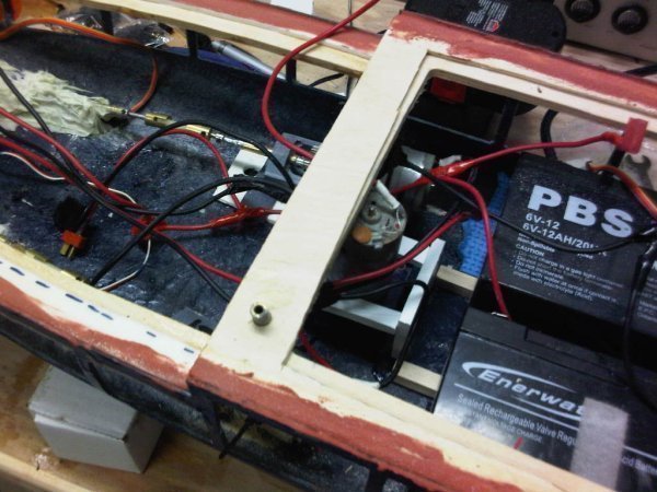

  13. bb26
    I know it looks like a bit of a rats nest for wires. I am still getting the hang of wiring electrical.

  15. bb26
    I am happy with it. I will try to plumb in the pneumatics tomorrow.

    The battery tray has been completed. The poppet trays have been installed. The servos have been screwed into the trays. Pump switch has been velcrod into the hull. The bottle has a holderbeen created. The internal armor has been built for the rear. It is a thick shower curtain taped up. It is Velcro'd into place.Pictures to come,
