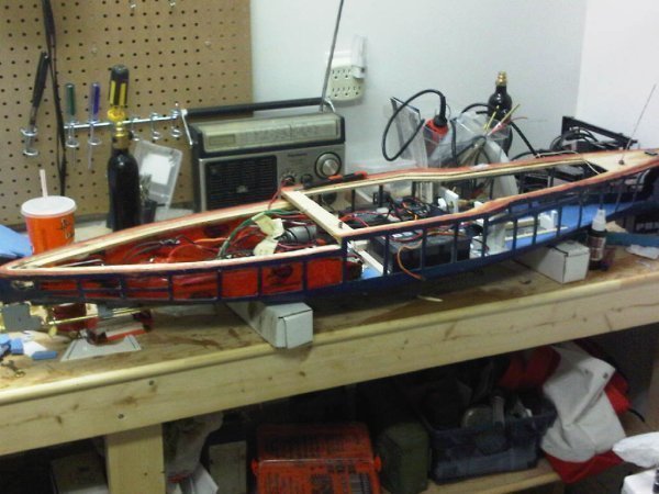

    Thanks Iceman. Do you put anything on the end of the sensors? So here are more pics of the build.

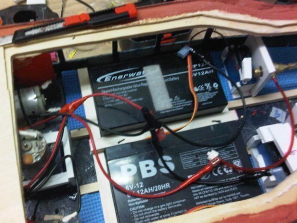

    Thanks Iceman. I will be testing the switch when I sheet the hull. The pump is being run through the main drive batteries.

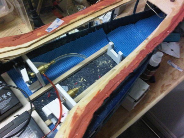

    I picked up the thread lock. i have started threadlocking the pneumatics. I have found a 10/32 screw to plug a 4 port x fitting.. More pneumatic work tommorow.

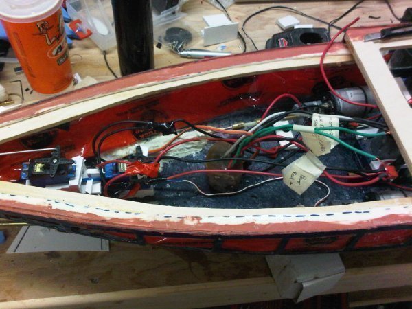

    I have also got some pump hose and it has been attached. I just need some more resin to make sure the motor mounts do not move.

    The pneumatics have been completed. No leaks. No blown hoses. cannons fire. It is just a little clean up to make sure the deck fits snugly. Next step. Complete armor belt and then start sheeting. The hose has been connected to the pump.
