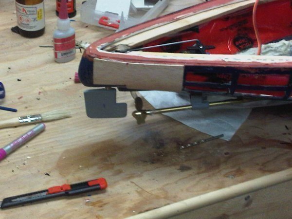

  14. bb26
    Here is the start of the sheeting.
