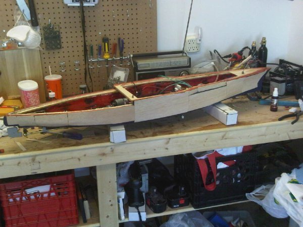

    More work done today. One side has been sheeted. I have also started the other side. Pics will be posted later.
  2. bb26
    here is what has been sheeted. once the hull has been completely sheeted, i will fill the gaps with bondo. then i will apply a layer of silkspan.
    Looks a lot better than the Sodak sheeting Paul. Good work.

  5. bb26
    The other side has been sheeted. Bondo tommorow.

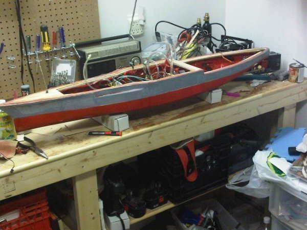

  18. bb26
    Some further update to the build. The hull has been painted. i will post pictures tomorrow. The switch gets built tomorrow and tested.
  19. bb26
    Here is a shot of the painted hull.
  20. CURT
    Looking great there Paul!
