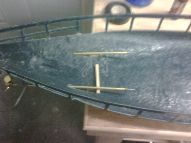

    well I have the battlers shafts with stuffing tubes. I just want to make sure the tubes are aligned properly.
    Should be no problem.

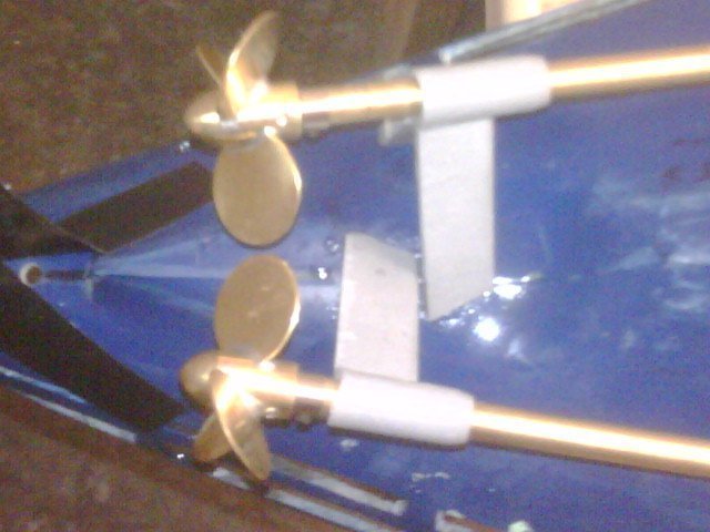

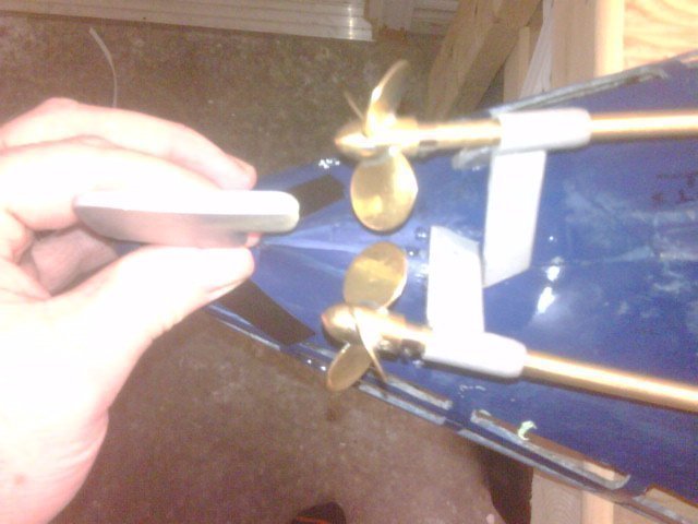

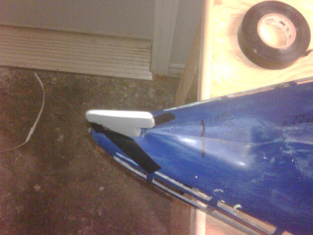

    Well here are some pic of the shaft rudder area. The rudder is being held in with tape.
    Looks good so far Paul. I thiink the longer shaft entry hole was the first one I cut. I think I didn't get around to making the other one longer. However if you find that the shorter hole will align the shaft better than when you get the other side installed just fill in the additonal gap with resin.
  17. bb26

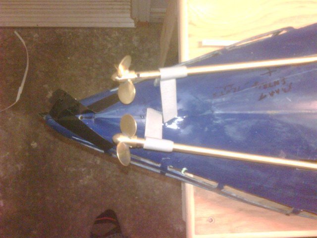

    The shafts are temporarily held in with CA. So here are some pics:
  18. warspiteIRC
    warspiteIRC RIP
    Aug 17, 2008
    756
    Annapolis, MD
    Support the ends of the shafts inside as well

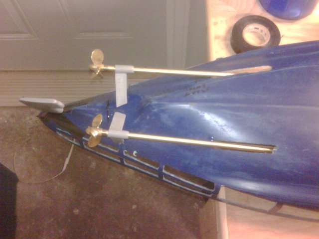

    I have made a minor change on how the shafts are installed. They are now more angled towards the rudder. There is enough clearance that the props do not hit each other.
  20. bb26
    Further movement of the shafts
