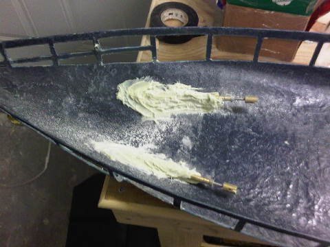

    Well some more progress today. The shafts were resined in today. I used this two part resin and it was more like a thick paste rather than liquid.
    The shafts are now fully secured.

    Here are some more pics of the resining.

    What is that goopy stuff on the shaft entry holes? Is that the Resin?
  19. CURT

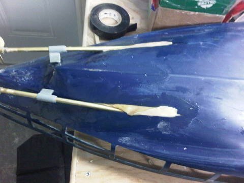

    Paul to prevent it from ooozing through the other side place painters tape on the underside. Peel off when the resin is dry.
  20. bb26
    That was done. The outside on the hull came out smooth. I used a bit of the liquid bondo resin to fill in any gaps on the outside of the shafts.
