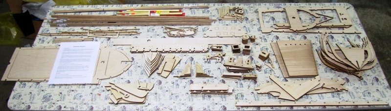

    First, an apology. Never did I think that the Constitution would take this long to design and kit. Looking back, I should have realized that the complexity of the ship, the differences in the ship from my current kits, and all the extras I wanted to put in, was just too much. I should have expected that I would lose interest in the project before it was done. So to all those that have lost patience with me, I'm sorry. For those still interested, I think you will forgive me when you see the final result.
    I was very excited when I picked up the prototype kit today. I turned in the drawings over 5 weeks ago but the laser has been down and the wait has been killing me. In total there are 9 sheets of 1/4" ply and 3 sheets of 1/8" ply, making a kit that weighs almost 18 pounds! With the 500 watt laser it took 40 minutes to cut all the parts. Just to give you an idea how this differs from one of my normal kits, one of my cruisers has about 1500 linear inches of lines, composed of about 2500 individual segments. The Constitution has 6400 linear inches of lines (2200" of those just in the deck lines), composed of about 5400 individual segments! It took me an hour and a half just to punch out and sort the parts; normally I would be done assembling the kit in that amount of time.
    Here's all the parts:

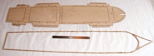

    Here's the deck and railing:

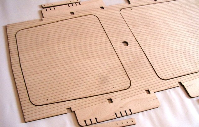

    Close up of the deck lines:
