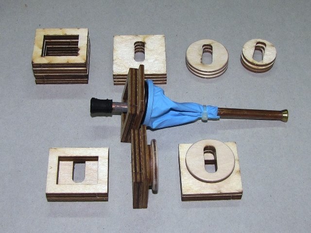

    I assembled the cannon ports tonight, and it looks like they will work as planned. First there is the cannon port frame with a 1/4" wide side as specified in the rules. Then there is a backer that narrows the slot down to a cannon barrel width, followed by a 1/8" spacer and finished with a 1/8" piece that acts to retain the seal. The finger of a rubber glove can be placed over the spacer and then retained by an o-ring. Tie off the glove finger around the barrel and you have a cannon port where you can freely adjust the elevation and is reasonably waterproof. At least a big slug of water won't enter the ship if the cannon ports go underwater.

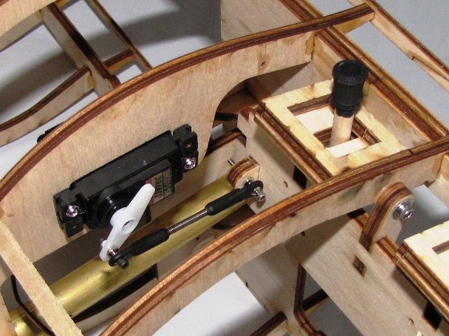

    Mark, I was just reviewing the pictures you've posted again and I noticed that one of the ribs has what looks like vertical servo mounts. Given its location near the mainmast, am I right in guessing that's for elevation control of the cannons?

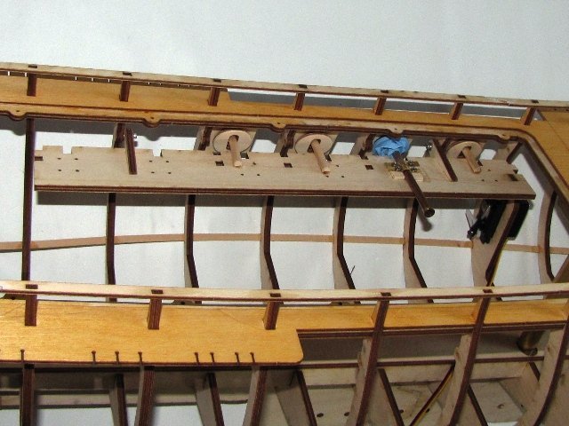

    Good eyes, that is exactly what the servo mount is for. For the final piece de resistance, I give you the gun deck:
    It pivots on holes set in the ribs and contains space for 6 guns. The servo underneath allows you to pivot the deck up and down. Also in this picture you can see how the gun ports are glued to the ribs and one of the pivots.
    The gun deck in action:

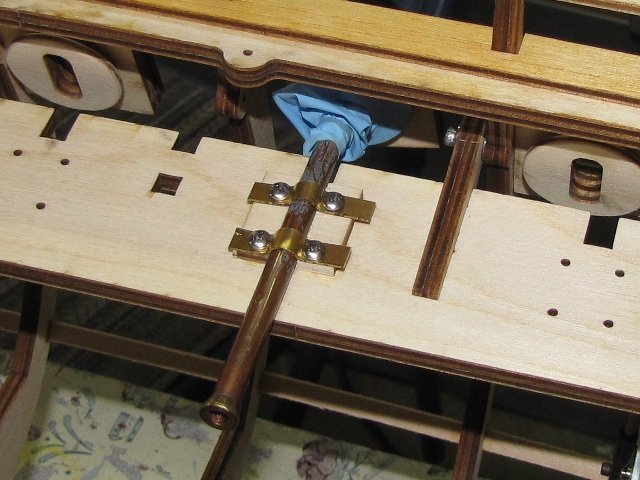

    One thing I didn't anticipate was how hard it is going to be to install or change the O-rings on the gun port. I guess if the seal is needed then the effort will be made, otherwise I anticipate most captains will leave them off. The barrel is held securely in place with a couple of pieces of scrape plywood and some brass straps.
    Overall I'm pleased with how the gun deck performs. Just about every slot and hole in it is wrong, so I have a lot of corrections to make.

    I do love the elevating gun deck. With that gun deck moving, we are going to have to set the cut off switch to turn off the guns at their zero elevation as the ship is level.... As long as those guns can not elevate above zero we are good.
    The gun mounting is going to be easy... just a clamp and maybe a zip tie behind the elbow to hold it secure...
