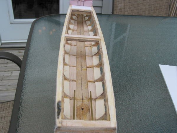

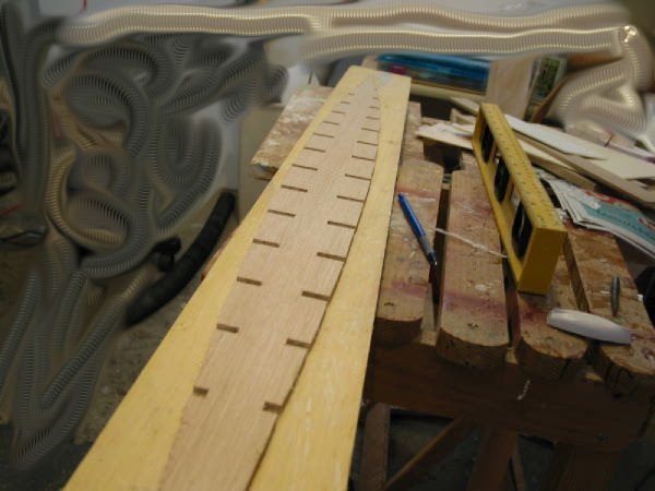

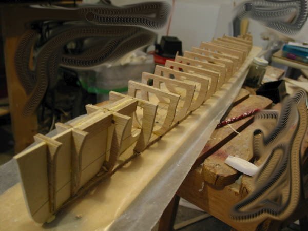

    Here is my 'keel'. I have taken the lines from the plan and cut the form. This gives me a flat bottom with about 1/16 of an inch missing from the bottom, which I will fill in later. First the 'keel' is screwed onto a flat board. This gives me a nice secure base to work from. Next, the ribs and end pieces are inserted into the slots (The slots for the bow and stern pieces are not yet cut in this photo).

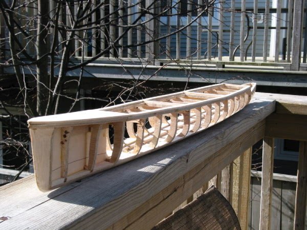

    Here the ribs and end pieces are installed. The bow is so narrow that it contains no useful space. I have decided to bring the bow piece back to station #4, to provide stiffness. This also acts as armour for the bow section, so I won't have to fit it. This also means that I cannot use the forward turret, since it is between stations #4 and #3. No worry -- since I can use one of the casemate guns insstead. (Note: I will need to drill holes in station #2 to allow water (and BB's) to pass into the rest of the ship.

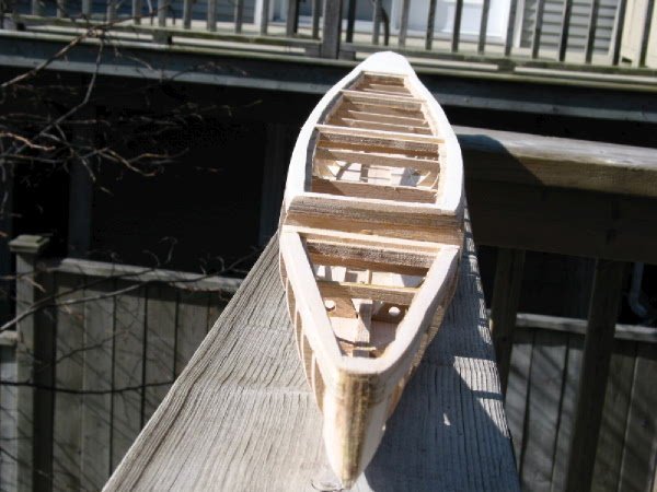

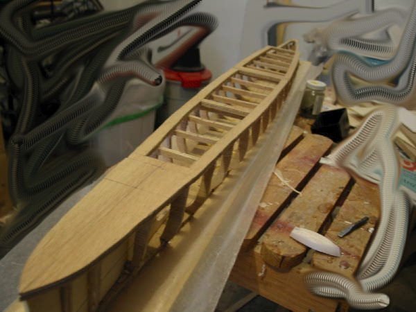

    Here is a shot showing that I do learn from my mistakes. I have pre-drilled the holes for the prop shafts. (The camera lens has warped the perspective). The little horns on the sections were supposed to fit to the edge of the deck (The deck is narrower than the hull), but it didn't work and they were cut off.

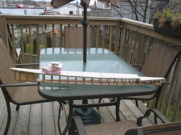

    Here the top rail is dry-fitted. Once the top rail is on, I will cut the cross pieces of the ribs. I am handling the curving deck by doing straight lines angled to approximate the curve. This will allow me to have flat hatches, I still have the top deck (1/8 inch plywood) which will fit over the top rail and smooth out the curves. Also -- once the top rail is on I can remove the hull from the board.

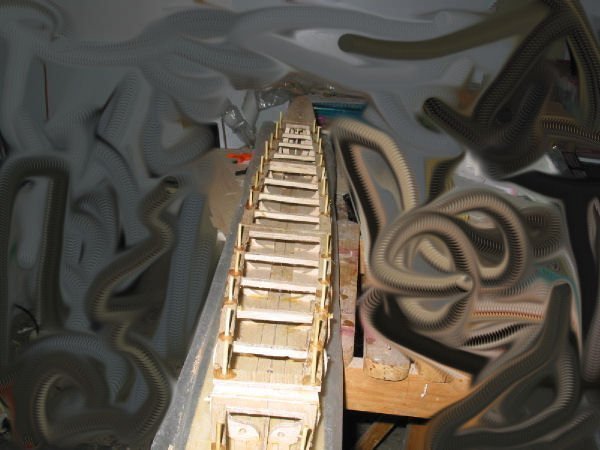

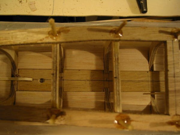

    I have attached the caprail. On the last attempt I tried to cut notches in the cap-rail and fit them into tabs on the section forms. However, because of the curve of the deck the placement for the notches got progressively out of place (The overhead view being shorter than the actual length of deck). This led to some cutting and trimming and an overall bad feeling.
    This time I simply glued the caprail directly on top of the sections. I let the glue dry and then drilled holes through the cap-rail and into the cross piece. Then I tapped in an epoxy covered peg of bamboo (cut from a barbecue skewer). Once the eqoxy is really set I'll trim and sand the pieces flat. Since another 1/8 inch deck is going over this, no one will ever see the mark of the peg
    I also started gluing in the water channeling / side pieces (to make the side solid up to 1 inch below water line) . This is 3/16 balsa. I will cap it with 1/8 ply and then epoxy over it.
    So far so good. It's not perfect I am pleased with it. I will hold off on completing the water channeling for now. The next priority will be to install the prop shafts because that's were the last build foundered.

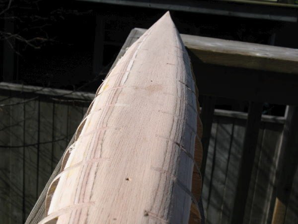

    I have some shots showing my progress so far. I have the deck on and the hull sanded more or less into shape. Some more sanding required, but it's almost there. The top layer of water channeling (between the ribs) is in except for the very back where I will install thge prop shafts first.

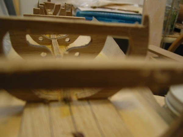

    And the end-on shot. Here, only one cross piece has been cut away. They will come out later. You can see how the bottom layer of the cap-rail forms the lib for the hatch.
    A look at the bottom. I still have a layer of 1/16 balsa to put on the very center. This will take care of the flat spot. You can see the holes made by the screws that held the keel to the board.

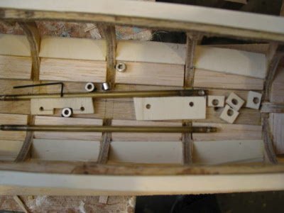

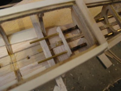

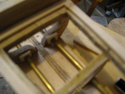

    Three shots showing the prop shaft install. First the 'kit' I used.
    Here it is in the boat. The pieces keep the shafts parallel. The other piece is at the stern. I lined everything up, then tacked the shafts in place with hot glue -- then used CA on the tabs ...
    and then slide them up against the bulkhead. Then I expoxied them.
    Next I will finish putting the waterchannling and bottom pieces on the hull and sand it all up.
