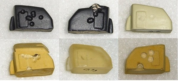

    I completed some tests on different casting materials. The 6 test turrets are, from left to right, regular water putty, Alumilite, water putty coated with tool dip, silicone, West epoxy, and water putty with micro balloons.
    Results:
    Top left and middle are the coated water putty. It survived the hits pretty well, much better than the uncoated. Once there were multiple hits close together or close to the edge, the casting did fracture. The Alumilite in the top right corner showed a couple of dents but was basically unharmed. The plain water putty in the bottom left survived some pretty good hits, but split when a several hit in the same place. The epoxy in the bottom middle was completely unmarked on the outside, but you can see an internal fracture starting in the middle of the door. The bottom right is the water putty mixed with micro balloons - the holes are pretty deep, but as long as the hit was not near the edge it survived. I don't have a picture of the silicone, but as you can expect, the BB just bounced off. So in order of preference:
    1. Alumilite - 8.6 grams turret weight, cost $0.328/turret, expensive but light weight and durable.
    2. Coated water putty - 11.5 grams, $0.062/turret, cheap, slightly heavy and reasonably durable
    3. Water putty - 11.3 grams, $0.062/turret, cheap, slightly heavy but a little brittle
    4. Epoxy - 9.3 grams, $0.443/turret, expensive and possibly too brittle for long term durability
    5. Water putty with micro balloons - 6.4 grams, $0.035/turret, light but soft -- use only if weight is paramount
    6. Silicone - 7.8 grams, $0.018/turret, difficult to get a good casting, not paintable, watch the ricochet

    How fast was your cannon shooting for these tests?

    The shooting velocity was 200 - 225 feet per second.

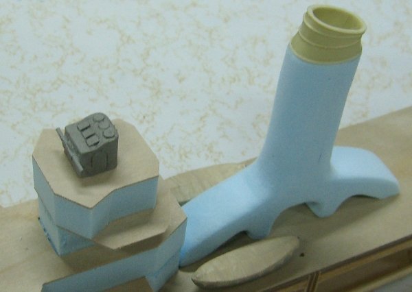

    Well, I took a couple hours off tonight from molding and finished up the basic superstructure for the Gridley. I still need to put together some torpedo tubes and a spotlight closer to scale. I am very pleased with how the director came out.

  16. NickMyers
    Looks good - one question - the stack seems overly tall? It looks like its taller than the director, but every picture I've seen it looks like the stack is the same height or a little lower.
  17. hairy_apple
    hairy_apple Member
    Jul 1, 2010
    138
    Amazing!
  18. Anachronus
    Gorgeous, but I agree with Nick, the stack does seem too tall. The hull also looks a bit stubby so it may be a bit of photo distortion.
  19. rcengr
    Nick is right, the stack is too tall. It's too tall by at least the height of the stack topper, which I added after I made the foam pattern for the base. Once I make the mounting pedestal for the director and glue the forward superstructure together, I'll check the height and shorten it to a better height.
  20. CURT
    I agree the stack looks too tall but overall a great looking ship.
