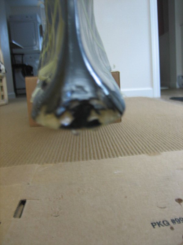

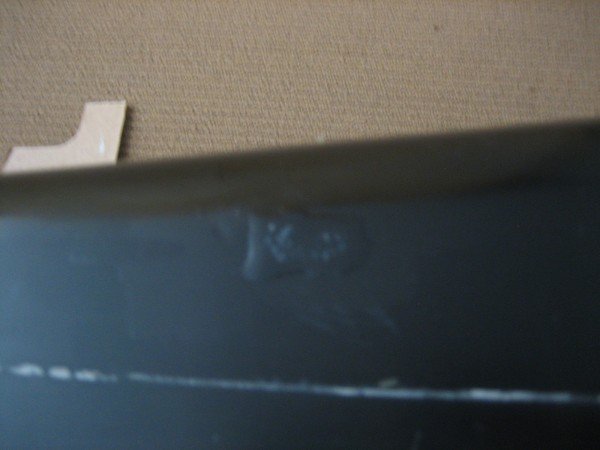

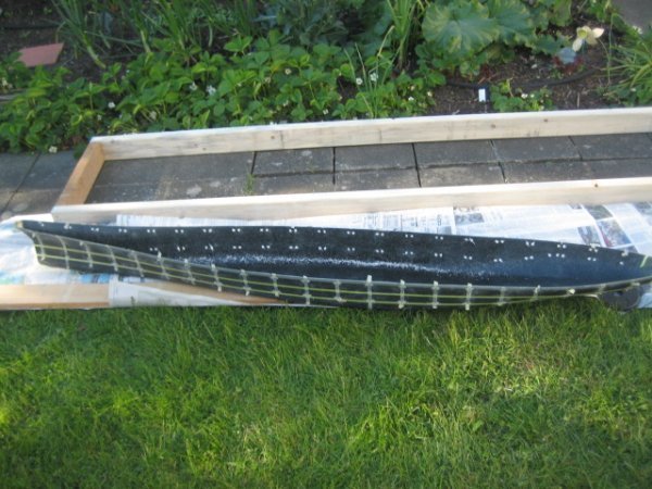

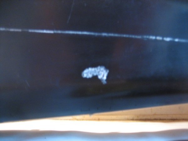

    Alright so quick update on the build. We have bought and applied West Systems 105/207 epoxy to the areas that were damaged previously. It is still currently curing, but I have a few questions as we have never used epoxy before.
    When i apply epoxy to secure things to the hull or install prop/rudder, do I want to thicken it? When we applied it last night to the scratch on the underside and the bow, it was syrup consistency. It worked fine for the underside, but it did not fill the gaps and we could not mold it to the shape of the bow.
    If I should thicken it, what consistency should I be looking for. The West Systems guide had 4 consistencies: Syrup, Catsup, Mayonnaise, and Peanut butter.
    Below are pictures of both epoxy jobs. I apologize for the blurryness, the camera is having trouble focusing, but essentially, you can see the epoxy applied did not mold into the grooves on the bow, but thinly coat, similar to a coat of paint.
    Underside Epoxy
    I have attached both the before epoxy and after epoxy pictures.
    Bow Epoxy
    Once again, this is kinda blurry, but you can see what I mean by a thin coat rather then filling the grooves.
    My last question is what type of sand paper should we be using to sand the epoxy down to shape, and should it be wet or dry?
    P.S. Why does nobody seel 3/8" tape when I live...
  7. rarena
    I like the peanut butter consistancy. When I put my shafts in, I ca them into place, tape the outside of the boat and mix the epoxy with chopped fiberglass. Apply to inside. I have used paper towels in the past with good results attaching things like gun mounts and skegs to boats but definitely the fiberglass. I sometimes use automotive fiberglass to build things and then seal it with epoxy, that works too.

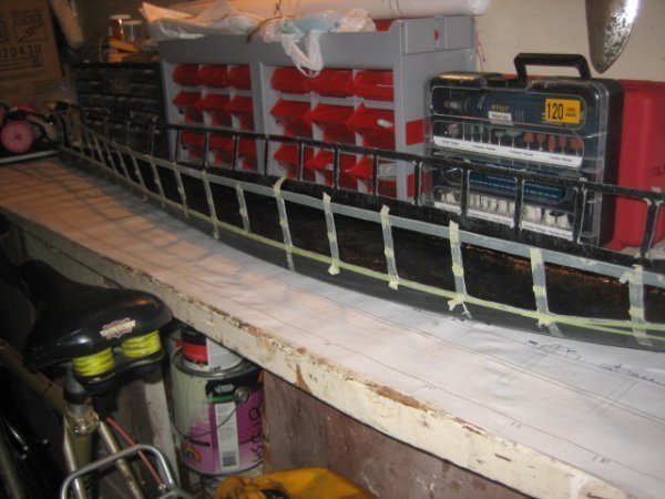

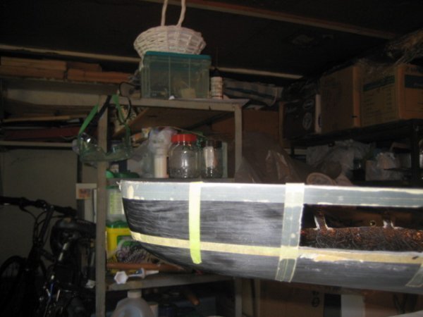

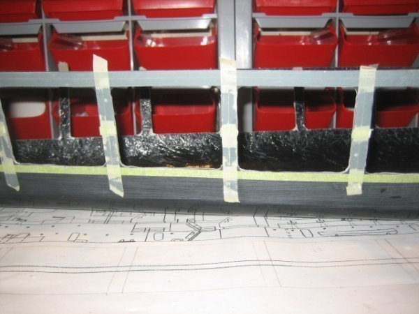

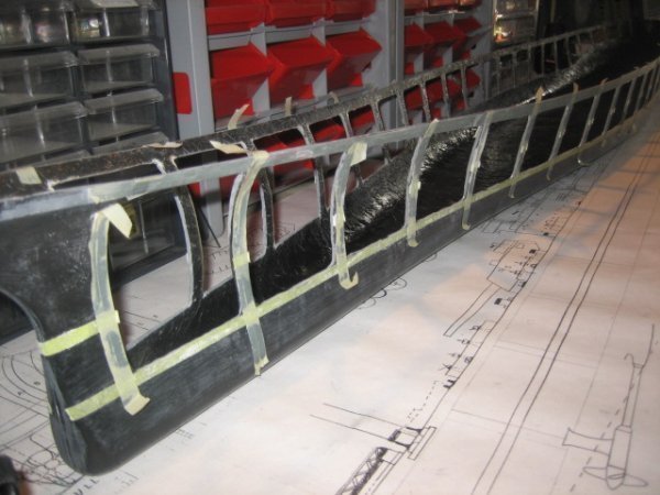

    Alright, over the past couple of days, we managed to drill the window holes and cut out the windows.
    Drilled Holes
    Cut Windows
    Is it alright if the windows corners are rounded? We sanded them down using the dremmel sand attachments.

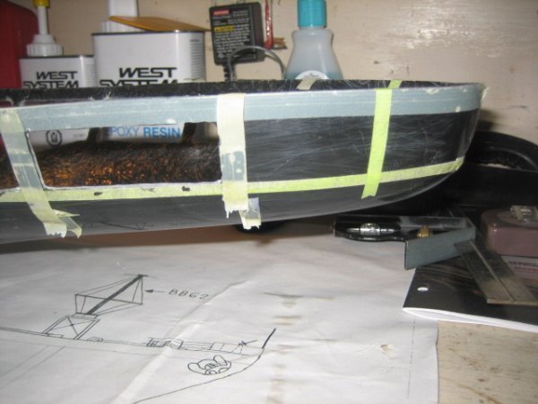

    Although almost all the cutting is completed, we had 1 quick question regarding the stern. We originally measured 2 inches from the tip of the stern (not following the curve of the hull) and placed tape at the 2 inch margin. However, by doing this, the window is not 3 inches wide. So my question is, should the rib previous to the last window at the stern be less then 3/8"? Or am I allowed a shorter window with 3/8" rib around the stern?
    Port Stern Window
    Starboard Stern Window

  16. Bob
    I always leave the subdeck for latter on.
    I like to get the gun locations marked in the hull so you don't put anything under them. The guns can't be moved.
    Then I like to get the motors and shafts installed. Then pump, then water channeling. The all the wiring and CO2 system.
    After all that is done I put in the subdeck. This way you can put the cross braces in places where they will not be in the way. Like right over the motor gear boxes. Or right where a barbet is installed.
    The little round parts of the hull you left in the corner windows are fine.
    Not all ships are going to divide out to exact 3" windows. I don't know Big Gun rules but it seams fine to leave the stern like you have it. But best to check with your rule set.
    You don't have to put wood behind all of the ribs. It is a good idea as the ribs will last longer. That "old style" Swampy hull is not as thick as the new ones.
    You should put them on every other one so you can hang the interior armor from them.
    Since you hull has been sitting around for a while make sure and check the width of it against your plans. The fiberglass will widen. My Kongo from back in 2004 is about 2" too wide in some places.
