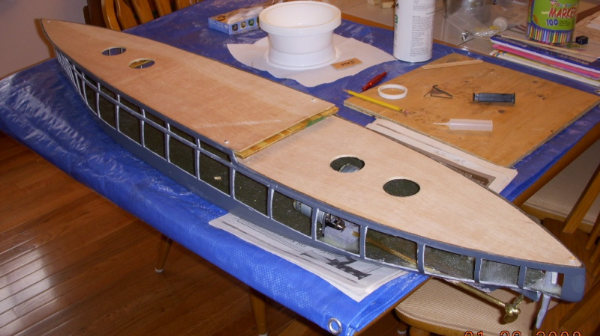

    Did some fitting of the decks and temporary holddowns. Really need some water channeling info.
    Where the lower deck meets the higher deck should this be trimed straight off. Any pics

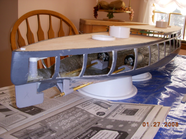

    Which way do the V supports for the shaft go?
    What is used to glue down the rings for cannons?
  7. djranier
    The subdeck sticking out needs to get cut off, and you need to make a peice to go from subdeck to subdeck. And then cut the main decks to fit. But I have to say she is looking really nice.
    The V supports slide up the stuffing tube, and the flat side aligns with the end of the stuffing tube. You can move it up a bit if you want to, I usually install it 1/4 inch from the end of the tube. You will have to sand the feet sticking out to match the contour of the hull, where you decide you like the placement. I then tack in with SG, and epoxy it in.

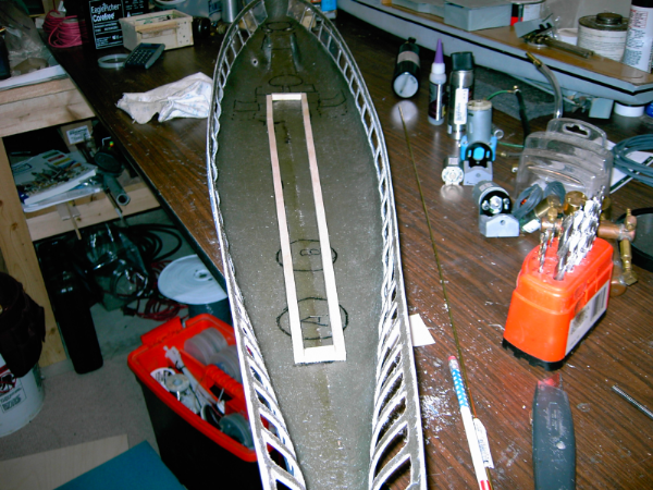

    Ahh water channeling, its good stuff, and very important if you dont want to sink to quickly. First off the basic idea is to help get the water to the pump as quick as possible, this also mean you want your pump to start pumping with a small amount of water in your hull. So you want your pump at the lowest point in the hull. You want your pump towards the stern, right in front of the motors.

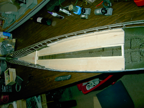

    For the water channeling the most common method uses balsa which you then coat with epoxy, its easy to work with and light weight. Basically you want to make a channel about 1-1/4" wide down the length of the hull it only has to be about 1/4" high. on either side of that get some balsa and cut and sand and fit it to the inside of the hull, then tack it in place with some CA and epoxy it all on place which also waterproofs it. In the bow, maybe the first 6-12" you dont need a channel that area should be taller than the rest of the channeling, say 1/2" instead of 1/4". Towards the stern where your pump will sit the channel should be large enough for your pump to fit in nicely.
    These photos are from Bob's build thread about his Washington but are the best examples of this method I could find. (Thanks Bob!)
    You can also see it in some of Steve's ships, check out the photos of his Maryland and Alabama.

    Guess I better buy some balsa pieces. Looks like channeling just gets the water to the center for the pump to get out fast. What about water in the back? Can it get in the channel?
    Still trying to figure which way to put the V supports. It looks like in Steve's Maryland pics the nub that sticks out more on one side of the down shaft goes toward the back.
    Sixth pic down
    http://www.geocities.com/wtpat2/maryland.htm
    See direction pic. This way or other way? Steve's looks like this way and cut the top the other way.
  10. djranier
    Nope thats backwards, turn it around, and then sand the end of the supports for fit.

    djranier
    Thanks, that was the hardest part of this almost.
    I'm looking at that water channeling. Does this really work better than without? What is the difference? Anyone ever not do it?

    I got a bunch of balsa in my travels today and plan to build a channel down the ship. I guess all the balsa needs sealing after building to fit and than the install. Still could use some further channeling ideas or pics. I think That's next as most djranier and Snipehunter stuff is done.

    take a look at me water channeling http://theclarkyempire.piczo.com/?g=10262331&cr=7&linkvar=000044 there are a few pics of it on that page the channeling is is a very importain factor. if ur ship was taking a high speed turn and had alot of water in it u could make ur ship capsize if there is no water channeling as all the water channeling. also it helps direct ur water on to ur pump.

    The Balsa as you see in Bob photo's is another way. But Don who has been in the hobby for a long time, does not like this method, he says he did use this method, but over time the resin cracks, and the balsa becomes water logged and rots, and the side it gets wet add weight to the one side of the ship. I have never used it myself, so I don't know.

    All three pics are great! Snipehunter sent Bobs pics and you guys sent some great pics. I have to look for those early djranier pics. I want to start to water channel tomorrow but I think I have to seal everything after I make it than install and reseal.
