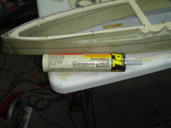

    I got the sealer at Home Depot, your ship will require 3 tubes I would think, maybe 4. It depends on how wide your channel is, and how deep you make the water channeling.

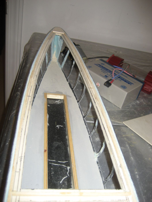

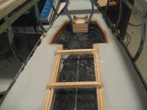

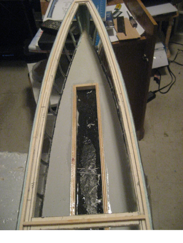

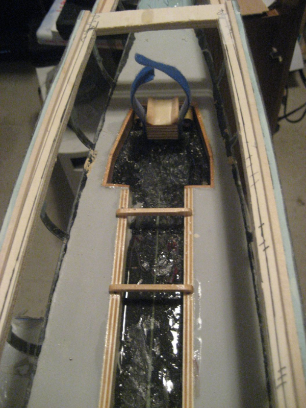

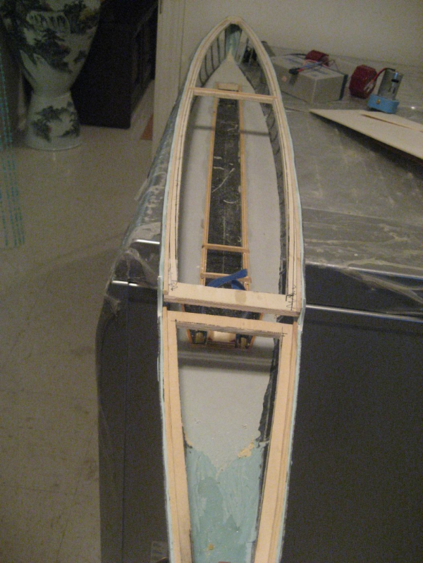

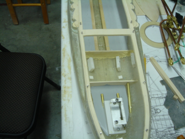

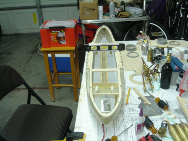

    Here are my pictures. Mike go ahead and post your also, would be nice just to see how someone else did it anyways.
    You can see I put in some temp walls to keep it out of the pump area between the mounts. I did the rear area first, and tilted the bow up, so that it sloped down a bit. A few days later I did the rest of it, and had the stern just lifted a little bit. I did mount some blocks of basswood in areas that I knew I was going to need to mount items to.

    Great pics! Does this stuff float? Is it heavy? Very interesting.
  14. djranier
    Not sure if it floats, have not tried it. A tube holds 10 oz, I have just under 2 tubes in the PE, and I'm still 2 pounds under max weight.

    But it adds weight down low, my PE making high speed turns and such did not even rock back and forth, she was rock solid in the water.

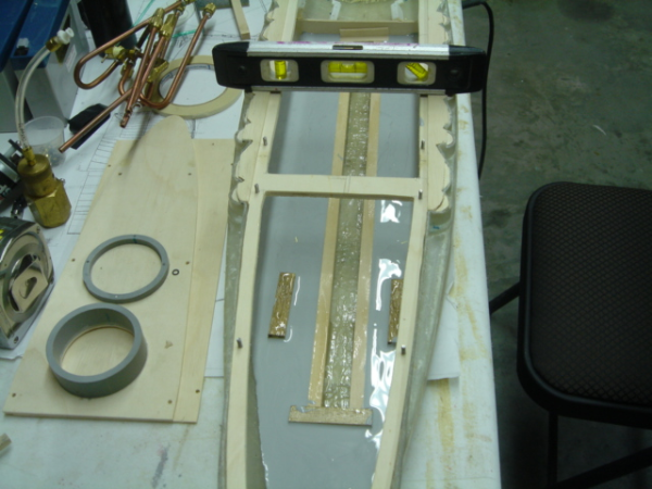

    Ok. Finally got some pictures taken of the Lutzow's concrete sealer water channeling.
    It is nearly the same as Dave's, with the exception I used thicker wood and left the wood in the ship. The wood gives me something to mount stuff too.
    By the way Dave, you did a better job planning your mounts than I did. Nice job. :)
    Ok, details: The water channel is 3/8" deep and 1.5" wide across the inside width. The wood is 3/8" x 1/4" plywood (basswood would work just as well). I wanted the pump to set solidly on top of the water channeling wooden sides.
    The gearbox area was fenced off with scrap 1/8" lightply.
    It took two tubes of sealant total.

  19. djranier
    2 Tubes, so 20 ounces. But does it look nice. I put all the gear in the hull and marked off where it was going to go, then put the blocks of wood in. It came out just about right, my water channel is a little crooked, but not to bad. That was just me measuring wrong some how.
  20. mike5334
    The velcro wraps around the motor which is mounted to the gearbox. The gearbox itself kinda floats on the hull bottom. I can remove the motor and gearbox assembly from the ship in less than 2 minutes.
    The two wooden cross pieces is where the pump sits. Yes, the pump does sit on top of the water channel so doesn't start drawing water until it reaches the top of the water channel, but when you are moving forward, the water will move towards the back of the boat and gets picked up by the pump.
    The weight of the sealer won't cause the ship to go down any faster because the ship will still be below max weight. The sealer's weight on the bottom of the ship should help stability a bit too.
    I absolutely love this method of putting in a water channel, especially for a fiberglass hull. From now on, I'll use it on every fiberglass hull I build. It would work in wood ships also if you didn't mind covering up the wood.
