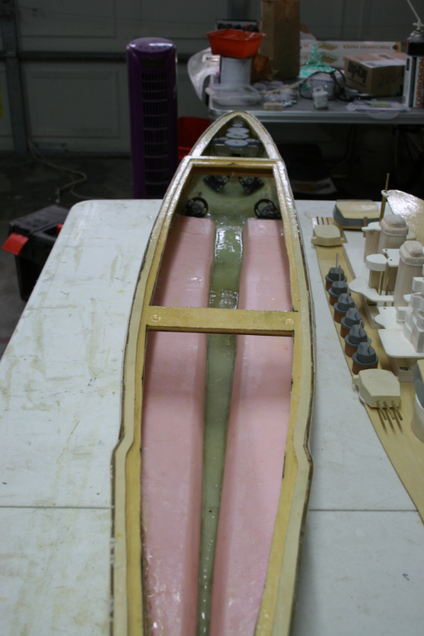

    With the BC pump, it sits on the head of the 4 screws, and gives you plenty of clearance, My PE pumps with like a 1/16 of a inch of water in the hull. True you are really not adding alot of water weight, due to the size of the water channeling, but you are giving alot of room for larger pump clogging material to get under the pump. Just about every time my Roma has sunk, it was not due to alot of damage, but the pump getting clogged, and not being able to pump out.
    I got the idea from Mikey D, but he got it from the fellow that was making a Bismark out of wood. He just put it between the frames to level everything off, maybe since its self leveling why he decided to try it.
    Yes I like the method also, its all I plan on using in the future. I could see the added stability I got by having the weight down low in the hull when I was making tight turns, she hardly leaned over at all, and did not sway back and forth when she came back to a even keel. When I took her out of the water, all I would have is a thin film of water in the water channel, with little to none on the sealant.

    It looks like the center channel is wide enough to allow the pump to sit in the channel. The area around the channel should go from the front to just in front of the gearboxes. It also looks like you also have sealer in the rear after the motors and gearboxes again. Does this drain to the channel?

    Mikes is wide enough, I made mine only 1 inch wide. After I got all the stuffing tubes in, I put in the temp wall and tilted the bow up just a bit, that way the stern sealer will run down towards the pump.
    Your wife will kill you in your sleep if you did this in the house, I think it cures when exposed to the air, so it will take a week or so to cure completely. The outside surface cures in a day, but the interior is still liquid, so you can do the stern pour, wait a couple of days, then level out the ship and do the sides and bow area. Then wait a week at least before you do anything else to it.
    You can start working on the Superstructure while you wait.
    Also I found my Roma water channeling picture, using foam, and glass. It pretty nice looking also. But you can tell it has alot of room in the stern for water to pool in. Most boats tend to sink by the stern, may be the reason they do, lots of extra water.

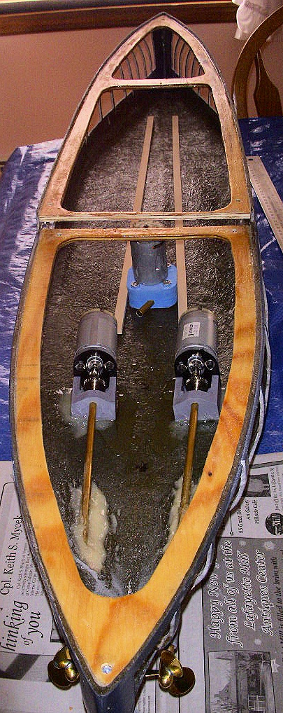

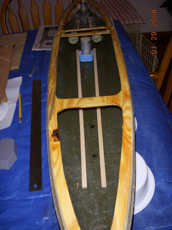

    Here are some pics of a water channel and pump. The channel is 2 inches at the pump and 1 1/4 inch at the front. Does this look like the right placement?

    My Richelieu's water channel was wide enough for the pump to sit inside the channel. It worked ok, though the replacement pump motor didn't. heh.
    For the concrete sealant water channel method, use enough to bring the level of the sealant to the top of your water channel wood pieces. You do not have to take it all the way up to the windows.
    If it was me, I would slide the sticks back to the gearboxes. :)
  19. djranier
    Yep all the way to the gearboxes, and then across also, so that the stern area can also be filled in. But figure out where the rudder servo is going to mount, so that you can have a mounting block in place, and look at where you are going to mount the guns, just to ensure they do not come down and hit the pump.
    Its about right from what I can see up front, but it really does not need to be so wide up front, my Roma is 1/2 inch and works well.
    Have you decide on your water channel method yet. With the sealer I would just make a 2.5 to 3 inch square open area where the pump sits, and then make the channel 3/4 at the front, and 1 in at the rear where it meets the pump opening.
    My boat is about 1/2 the size of your, the water channel is 3/4 from front to back.
    Somthing like this. But the run from front to back a bit closer together.
    Of course I would wait till you had the outer shafts installed, and sealed in.
