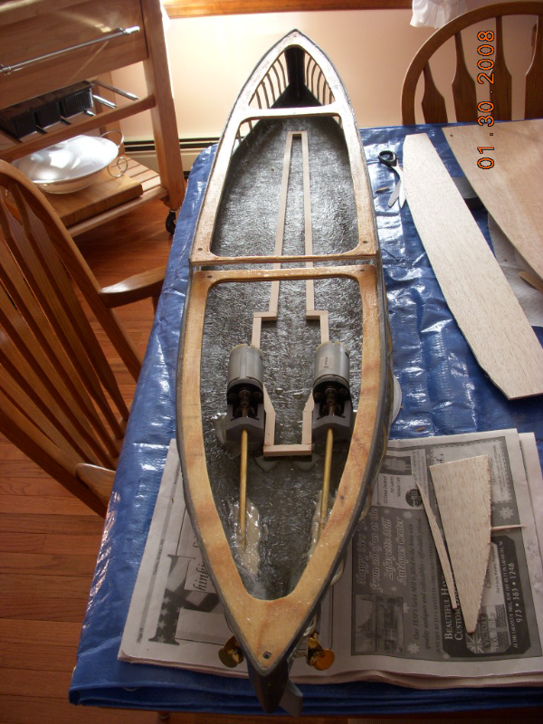

    Should there be room for the large cylinder to fit between the water channel in the front or should it sit up on the edges of the channel.
  4. SnipeHunter
    It can sit up on the edge, you dont really want a whole lot in the channel since that will block the water flow. One thing you might consider putting in the channel is a few small magnets, just glue them to the hull, you can even epoxy over them. They do a pretty good job of catching bbs that enter your hull and make thier way to the water channel, keeps them away from the pump so they dont somehow clog the pump or pump screen, it also makes them easier to remove since by the end of battle youll have a bunch stuck there not loose all over the place.

    Tried to work with channeling today but keep running into dead ends. At least I started just don't know where to go now. I know where to go just can't get the how to do it done.
  6. SnipeHunter
    what do you want to use to fill in the rest of the area with? unless you are going to use that sealant its probably going to require a bit of cutting and sanding.
  7. djranier
    The area between the motors I would also fill, but with a taper, from the high side towards the stern, with the taper going down as it goes forward till you get out from between the motors. That way the water in the stern will run down to the pump.
    Filling the area with balsa will be the easest I would think, plus no smell. Did Bob explain on how to seal all the balsa. I would coat the inside hull where ever you lay balsa, and paint the bottom of each peice with resin to ensure that water does not get under the balsa. Then build it up to just above the water channel with SG, like 1/8 max. Then sand down towards the center, from the sides at like a 2 or 3 deg angle, so that it flows down towards the water channel. Then seal the works with resin, and any gaps along the sides.

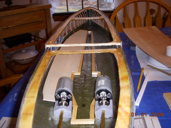

    Thinking of balsa. This is 1/8 inch balsa, pitched up on side, but would need some bottom support. Maybe Styrofoam?
    Maybe smaller sections would be better.
    Maybe 1/4 inch would be better.
