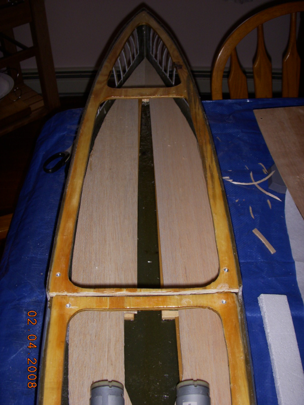

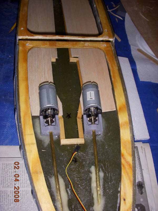

    The water channelling is coming along slowly but getting there. Rudder servo install also in motion.
    A couple pics of the channel in progress.

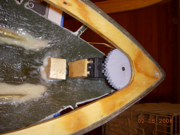

    Putting in the wood channel sides and a rudder servo block. Thinking of an L bracket to hold the servo forward.
    djranier
    Do you think the wood U is a better holder or do you think the L bracket would hold it in?
  11. SnipeHunter
    I would think a U would be less prone to twisting from the torque but it may not be enough torque to really make a difference. Or maybe 2 L brackets, but if you are going to do that it probably makes more sense to just make the U.

    How high do you think the U should be? would 1 to 1-1/2 inches be high enough? Would need some long screws to go through the U but thin screws so wood doesn't crack.Ron
  13. djranier
    I think 1 inch high would be enough, and 1 inch around each side. You could cut down the front edge of the U to 1/2 inch where it gets screwed down.
  14. SnipeHunter
    with that low profile servo 1/2" is probably fine. or maybe 2 1/4" U brackets with about 1/4" in between them. Heck 1/4" would probably be enough, just cut it out of a piece of good 1/4" ply, that stuff is plenty stiff.

    Gonna make it and it will surround the end of the servo and the wood mount I made earlier as it wood mount lifts it to the right height. Should be OK . Will post pics tomorrow.
    Any suggestions on cutting the hull for the dummy prop shafts. should I just look at the plan or do you have a better measurements as we brought the main props back toward the rudder which changed the measurements on the full size plan.
  16. djranier
    Just install like the plans show, all you will do with those are add drag disks to get yourself on speed.
