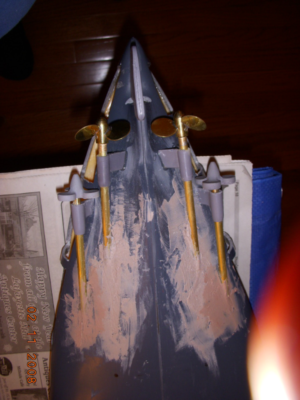

    I have to run motors as you said. 6V is OK for that? how long in time? Working on top deck and putting in shaft supports on dummy shafts now. Than as you said I better work on fixing the back water channel. Will post some pics later.

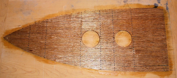

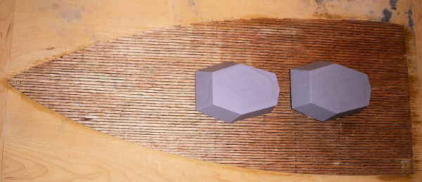

    Been working on the main deck. Cutting boards etc. Working real slow maybe next year this will be done.
