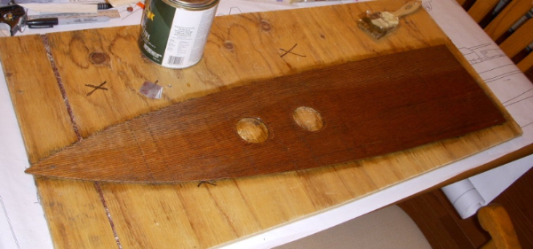

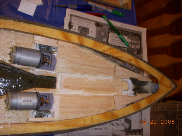

    Water channel suggestions needed!
    The back of this is giving me trouble trying to put a water channel in. Can't pour Dave's sealant because of smell, wood seems crazy. Any ship rear pics out there? Just suggestion would be great.

    Maybe you can use that two part polyurethane stuff they sell in craft shops? I used it to waterproof the bottom of my Richelieu. It dries hard and clear, flows out like the concrete sealant, and doesn't smell. It's a bit heavy, but on a big ship like yours, it wouldn't be a problem.
  9. Lou
    Use gap sealing foam from the home depot or lowes. Cut it with a steak knife (serrated edge) and then use the spakling compound to fill in all the holes. Cover it with epoxy like you wood channel. Just be careful of the amount you use.

    On my Nelson and Roma, I cut up the foam, glued in the peices, and sanded it down flush to where I wanted it, then glassed over it in the stern area, came out looking nice.

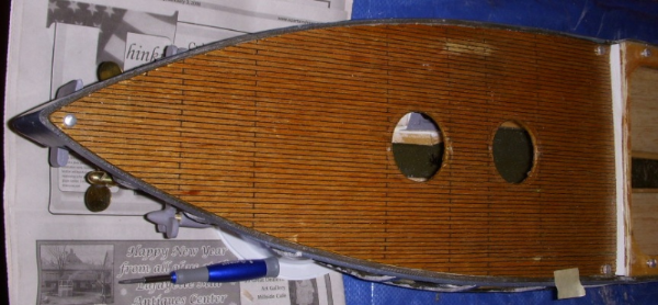

    We are still out here. Just working on freakin back water channel. Should be done by next Christmas.

    Doing OK but trying to get the water channel done and working on the top main deck. Going tooo slow gotta get moving. Later Ron

    Should have top decks and water channel complete and painted this weekend. Than I don't know whats next. Give me a clue as I think its time to install parts. One BB should take her down!

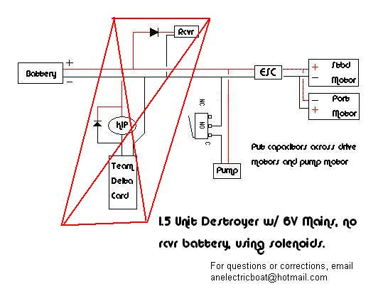

    I there anywhere where it shows you what to do. I don't see anything in the BC directions. Ron

    Thats a good looking deck Ron! Cant wait to shoot some bbs at it.
    Here is a basic wiring diagram if you are going with an ESC which I think you said you were going to. (if not its not a big deal) the original for this and another one that shows the micro switch setup if you aren't using an ESC can be found on the MWCI website in the how to section. Both these diagrams were made by Tugboat, i just drew lines on them. anyway I wouldnt do the part that I have in the red box with the X through it. You arent using solenoids yet so you dont have to deal with them and wiring team delta boards or anything yet. Also Im a big fan of having a separate receiver battery, in a big ship you have tons of weight so thats not an issue and I think it solves more problems then it creates.

    I guess I better order the $125.00 ESC that djranier recommended. Its close to putting it in. Unless someone has a cheaper Idea. I also wanted the pump on an RC channel. Is the pump on the switch ready for a servo in your diagram. I think djranier sent me some wiring diagrams.
