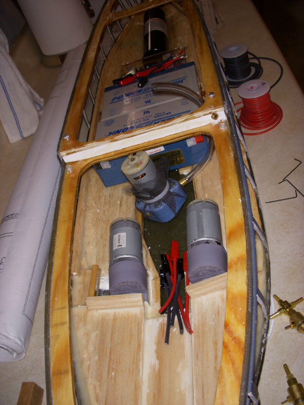

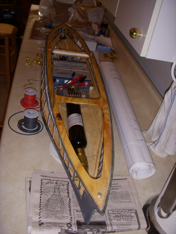

    Looks like we might be getting on track again with the build. Thanks Snipe for your help! here are a few new pics of the project.
    Here is a site to help with wire connector instalation.
    http://www.flyrc.com/articles/using_powerpole_1.shtml

    Need info on a servo box. Wanted to use tupperware container but haven't seen one to get ideas from. Any pics that can help please post. I'm thinking the USS Maryland uses 3 servos and it ESC to go in the box.
  19. mike5334
    Wow! Very clean and nice installation so far! Good going!
