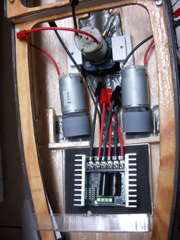

    Still looking for some picks showing the junk in the cotrol box and control box itself.

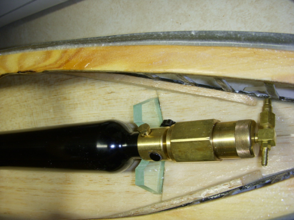

    Mount for CO2 tank should be ok I hope.

  2. djranier
    I just use a 1 inch dowel, and sit the ship on it, trying to balance it to the center, from bow to stern. So far they have all floated fine doing it that way to get a good balance.
    Now whatever you do, don't hook up the input wires to the speed controller wrong.
    The 0V, is the return, black wire going to the receiver, the 5V, is the supply from the speed controller to the receiver the red wire. This supplies the voltage to the receiver, don't hook up another supply, or you may fry the speed controller. Install a jumper from S1 to S2, then a single wire to the receiver. Usually orange or yellow.
    All the little switches should be to the left side in your picture, except for #3, which is to the right, unless you are using lipo batteries, which I do not think you are.

  4. djranier
    No you don't need to, the 5v is a output, it will run your receiver. Or if you want to run on a 4.8 volt pack, don't hook anything to the 5v on the board.
    My new Kumano is just powereing the receiver off the 5v of the speed controller, and it is working fine. Look at the PDF on the DE website, fig 2.2, shows a receiver hooked up.

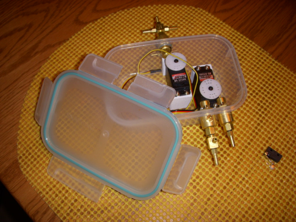

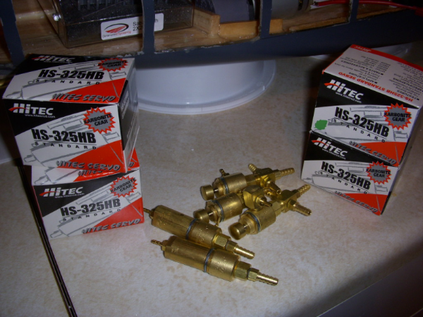

    Trying to get a radio box built but really stumped. The box I think is best built from 1/8 wood ply or 1/8 plexie. I'm not gonna use the tubaware box which I originally was thinking about. I don't know how mine would be set up. I bought 4 servos for the box, if needed, and I know the push valves have to mount through the side of the box. I was watching Bob's DVD but I think my ship has a different set up as I have the push valves. Is there a pic or a drawing showing my set up for the Maryland? I don't think the ESC goes in this box or does it? Where is the best place to mount this box? Maybe in front of the batteries? Where should the ESC go? Thanks Ron

    Hey djranier
    Now I need to see where djranier mounts his big ESC as I have the same one. Snipe also has one like Dave's and I want to see where to mount or do I want to put it in a box? Snipe has his sealed so he puts it anywhere.
  10. djranier
    In my Roma it is in a watertight box. But with my new Kumano it is coated with Scotchcoat, and mounted in the stern by the motors. Ran it, got water on it, and had no problems.

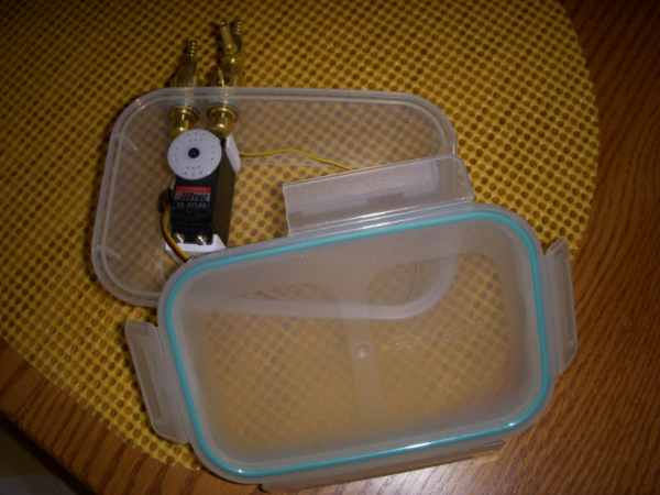

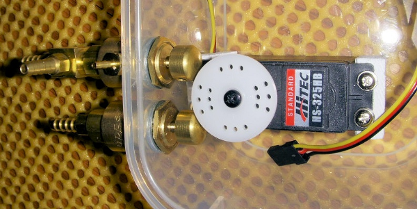

    I'm trying to build a radio box using a lock box but have to trim lock tabs. Maybe its not a great method. Any suggestions on making it better? Maybe I should build a box. I know I have to change the round disc to a half moon.
