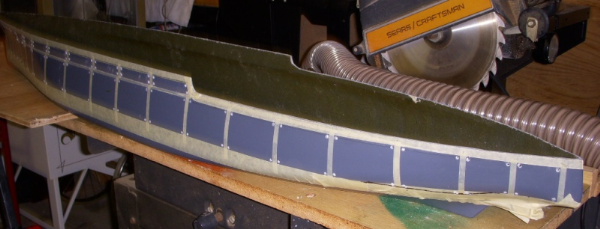

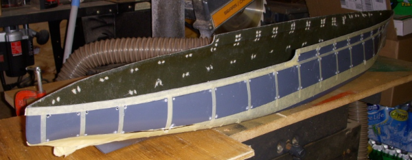

    Don't see any Don pics yet but here are some of my start. Still didn't get to the cutting of windows yet. Hate to cut up Rick's beautiful hull. Let me know if I'm screwing up. Ron

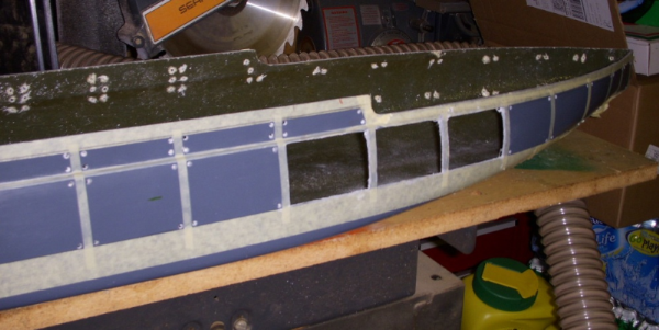

    I have pics up. I hope to cut the windows out this weekend.

    Looks good Ron! Now its just a game of connect the dots [;)]
    Yeah, what Snipe said!

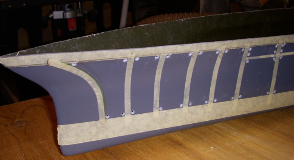

    Looks like I better start cutting windows before spring. Sorry Rick for cutting this GREAT HULL! Maybe I'll get the windows done this week. If anyone sees a problem don't be shy! Whats next! Sheeting? Gotta buy some glue for sheeting but where do I by it? Ron
  11. djranier
    No I would not sheet till near the end. Go with putting in the stuffing tubes for the rudder, and prop shafts next, or even installing the subdeck. The thin balsa will be easy to break, while you work on everything else.
