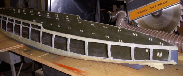

    Got all the stuff. Now how do you use these pumps? Do you fill little nicks you put in the fiberglass when you cut windows? Do you paint all the sub deck and deck with epoxy to seal it? Ron
    Nicks at the top edge should have subdeck behind them, so they're fine strengthwise, altho I fill the crack with epoxy. Nicks into the rib itself, I reinforce with wood behind the rib anyway (gives me something to hang internal armor on, main reason), and nicks on the bottom edge are in the impenetrable area, so reinforce it as you please :)
    As for painting with West... You paint it on while it is still very thin. Work quickly, in small batches, and do the top deck all in one shot so it looks reasonably uniform. If you plan on putting pencil lines on the deck, do that before painting and the epoxy layer will protect your detailing :)

    Thanks I'll call them tomorrow. Ron
  14. darticus
    darticus Member
    Nov 26, 2007
    238
    Continued cutting the windows. Soon I'll have the side done.its getting there slowly. Ron

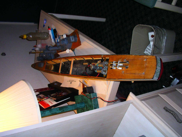

  15. SnipeHunter
    actually i do, not the greatest pic in the world but it works. oh and its actually from nats 2006, thats how much work I did on that boat between 2004 & 2006. ahh the joys of college.

    Nice pic. I guess you penciled it in than coated it with varnish or epoxy. Were the real ships a wood floor? Ron
  17. SnipeHunter
    yup thats exactly how i did it, it looks ok. most warships had teak decks as I recall, just a bunch of teak planks cause its very strong wood and holds up well to sea water, some of the more naval types please correct me if im wrong.
