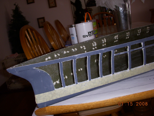

    I finished one side of my windows and removed some tape. Hope tape removal is ok now. Do you think I should clean it up more or is this ok? Can I go to the other side.

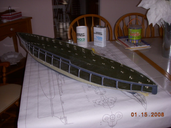

    Finished both sides of the windows using the Dremel #543 1 1/4 inch Carbide cutting shaping wheel and a #194 Dremel high speed cutter to trim. Ron
  10. SnipeHunter
    Sweet hull Ron, that looks good! See it wasnt that hard to cut that hull up ;-)

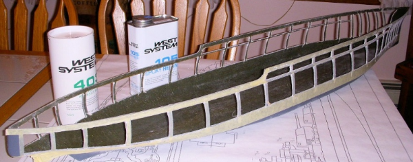

    Coated the sub deck and its drying. How many coats does it need before I put it in the ship?
  15. Ragresen
    Ragresen Member
    Dec 29, 2007
    322
    One good coat is normally enough. When dry look it over and see if you have any spots where it did not get coated. if so then coat again just to seal it all up.

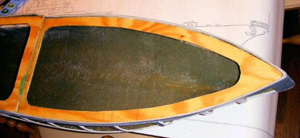

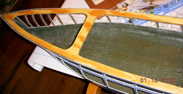

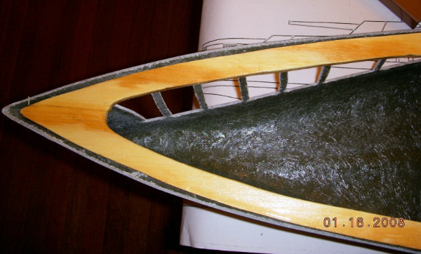

    How should the sub deck fit? It fits but needs some epoxy to take up the space or maybe it should fit perfect.see pics. Thanks Ron
  19. djranier
    Looks good. Question for you, are you fitting the main deck all the way to the edges, or going with a 1/8, or 1/4 hull stiffiner around the edges like I showed you on the Roma pictures. The center section has the hull stiffener around the edges, you can see the hold down latches, the stern section has main deck to the edges, since I do not need to take it off after every battle and is screwed down.
    Hull Stiffener - You can get some 1/8 square basswood from Home Depot, and tack it in with superglue all around the inside edges of the hull, on to the subdeck, this is what Don does. I use 1/4 in. Then resin everything to the hull. Gives the top of the hull edge more strength, but you will have to cut down the main deck to fit.
    Or
    Main deck to hull - Get a small peice of the 1/8 ply form the deck material, and hold it against the inside edge of the deck, sitting on the subdeck, to ensure the subdeck is at the right level, then tack the subdeck in using superglue, after you check it a few more times, the superglue can always be knocked loose if you need to move the sundeck either up or down. Apply more resin on the bottom side, and top side, and if you have large holes fill with your filler, to attach the subdeck to the hull.
    Either way works, with the hull stiffener way of doing it, it does give you a bit of room, if you are just going to use turning latches to hold the deck on, The other way will require you to screw down the main deck to the subdeck, again either way works fine, its just up to you.

    Don't know which way to go with this. Where do you get the small swivels to hold the deck? Ron
