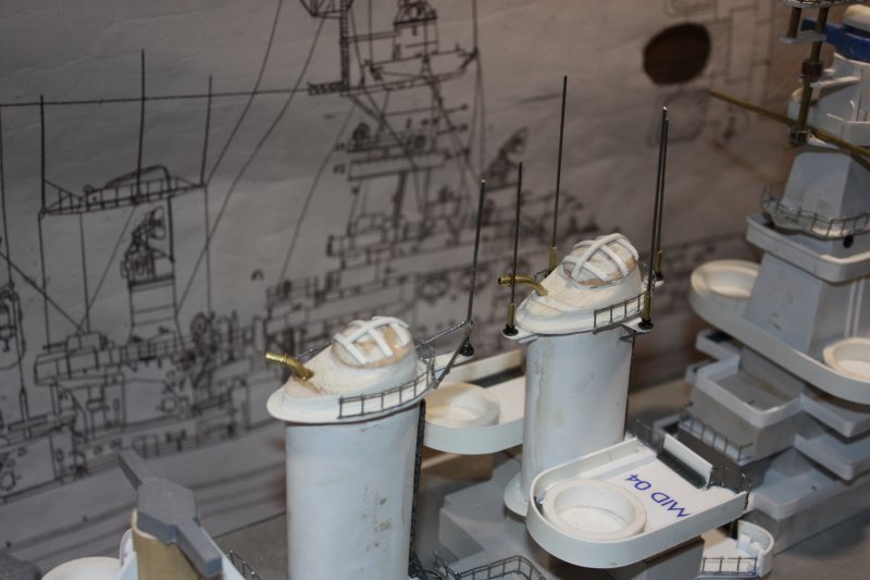

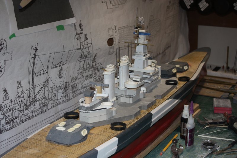

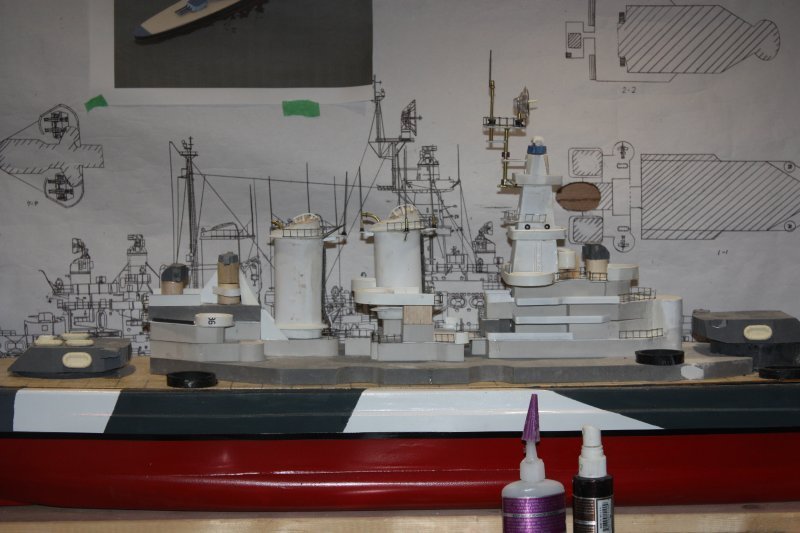

    I worked on the main Command tower , installing doors, caprails , rails made from chicken wire and styrene for various levels at the forward superstructure. More work to be done tomorrow but it's finally moving forward.
  11. CURT
    Work progress still being made on the superstructure. Today I worked on the upper mast works and the rails and rangefinders of the midships section. Worked on the rails of the aft section as well. It's slow going but it is building up nicely.

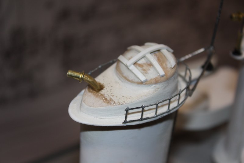

    More progress again today. This time however I felt the 2 funnels were fat so they both went on a diet and slimmed down to correct dimensions and they are lighter. I saved the funnel caps by cutting them off then took the pair of funnels and used the belt sander to slim them down. After I remeasured them and made minor adjustments. I then reattached the funnel caps and trimmed them down too. The aft gun director mid level platform was made and attached. Most of the rails in and around the superstructure are in place. 2 mini AA gun director tubs were attached to either side of the lower platform at the base of the command tower. I managed to space the funnels nearly exact between each other so I am happy about that. I didn't get a chance for photos. Next step I will wrap thin styrene sheet around the funnels themselves. Then I will detail the funnels. From there move back to the armored conning tower itself and detail that.
