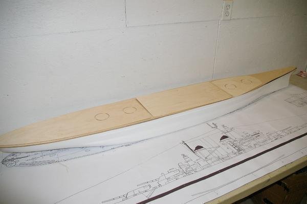

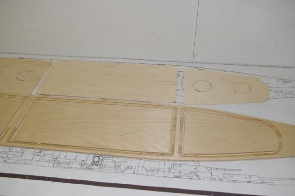

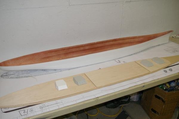

    We have a new project in the works. And this one will be a group project. With the exciting news that Strike Models is coming out with a fiberglass hull for the hypothetical battleship USS Montana, some of the folks in our group have decided to take on this project as a club boat.
    We will all pitch in to complete the boat, and maintain it so that it is available at our events for folks that may be flying in, or otherwise unable to bring their own boat.
    If there isn't someone dropping in that needs the use of the boat, then we will have the ability to take turns running this monster.
    In Treaty, it is the only allied 8 unit battleship. The equivalent of the Japanese super-battleships of the Yamato class.
    This should make for a very interesting build. And also perhaps a very interesting build-thread. As we are hoping to get all of the folks that are taking part in the project to keep this thread up-dated.
    So if those folks are already on here, please take the time to chip in, and post your thoughts, and plans.

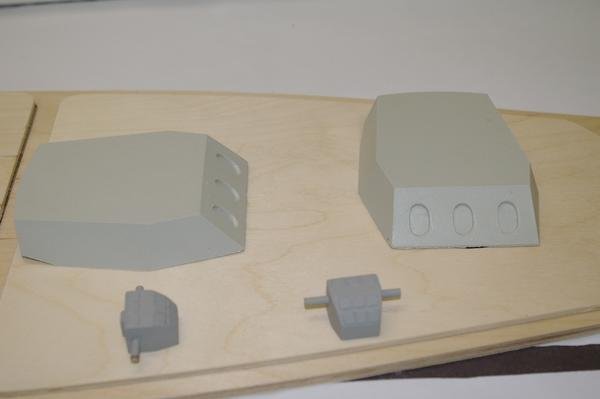

    I love the detail on those range finders! Also, Stockamoto, I agree with you; I want one, too. But, the Iowa-class is monster enough for me, at least for now. Still, having that extra main battery aft is a beautiful thing for symmetry.
    I really can't wait to see this monster finished!
  20. froggyfrenchman
    Haha.
    The range-finders are from Mark.
    I just threw them in the photo to make you all salivate a little more.
