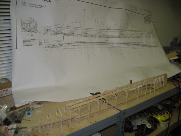

    Right off the bat, this ship looked like a challenge to build. It is a long narrow hull, especially the front quarter of the ship. The stern tapers to a near point which may make it tough to fit the rudder's control system in. Lastly, the deck curves upwards towards the bow, meaning a different building technique is required to ensure a straight, non-warped hull.

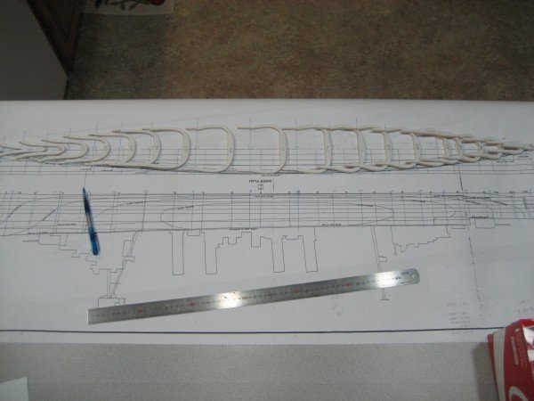

    I got hands on three different plan sets. One set simply didn't have enough rib stations to use effectively. A second nicely detailed plan set looked very good except it was drawn in 1:172 scale. Finally, a pretty good BDE plan set in the correct scale arrived from Strike Models. But there was a small problem! The rib outlines on the BDE plans did not match the rib outlines on the other two plans.
    So the first step to this build was to scan, enlarge, and add the allowable 3/8" additional hull depth to the 1:172 rib outlines. Next, using a drafting scale, I transfered the 1:172 plan's rib stations to the side view on the BDE plans. What I ended up with is a good set of 1:144 scale rib outlines that matched the 1:144 scale plans from Strike Models. Hopefully, the calculations are all correct, else this is going to be messy!

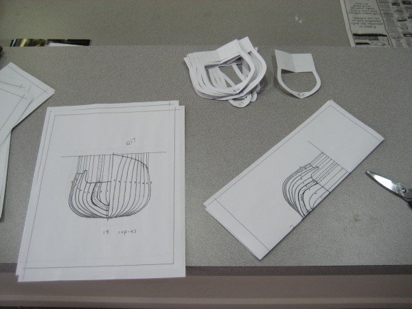

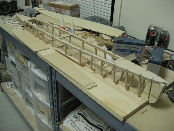

    Now that the plans are straightened out, it's time for the next step: making the ribs.
    I tend to build ships upside down on a flat board. Great for flat decked ships like the Bearn CV and the Verite PDN, but difficult for curved decked ships like the Richelieu BB and the Omaha CL. A modified flat building technique is used to accomplish this. First, a line is drawn across the tallest rib on the rib outline template. This line represents the building board. Next, a "leg" is drawn upwards from the top of each rib to the building board line. Once the template is cut out, you get the rib with extra material on top of it.
    From there, it's paste on wood and cut.

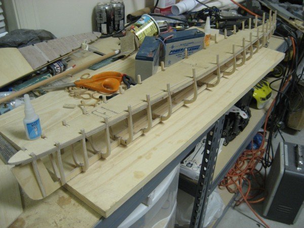

  3. mike5334
    The basic hull is framed upside down. Notice how the "legs" on each rib section keeps the ship level in spite of the upwards curving deck. This is crucial for a straight warp-free hull! Once the hull is completely framed up and glassed, the "legs" will be trimmed off and sanded flush to the deck.
  4. Anachronus
    That is brilliant!
  5. Bob
    Mike you are a great wood worker.
    Make it a plug, pull a mold and get some fiberglass huls out there. I have one on my to build list.
    Mike my great friend, you are too clever by half. I shake my fist at the heavens and curse eternity that NC is not right next to GA :) You know I love your work already, this should be awesome.

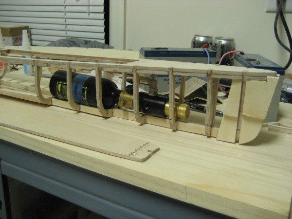

    After adding some of the waterchanneling bottom and a 3/16" wood doubler under the 3/16" thick deck, the hull frame is stiff enough to handle without warping.
    With the legs trimmed off and sanded down, the deck's curved outline is evident. The hatches are 3/16" thick birch plywood which will bend to fit the curved deck shape and help get that critical water seal needed for a small ship like this.
    Although the bow area is tight, there is enough room for a 3.5 oz bottle and a Strike Models adjustable regulator to fit with about a 1/4" to spare on each side to the ribs.

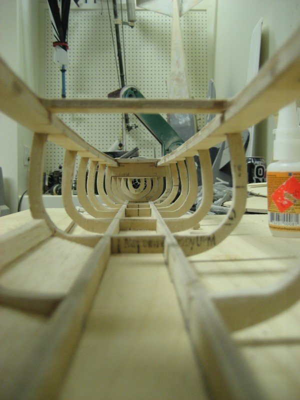

    A shot from inside the hull looking aft.

    I love that shot from inside the hull. really reminds you why they're called ribs, eh?
