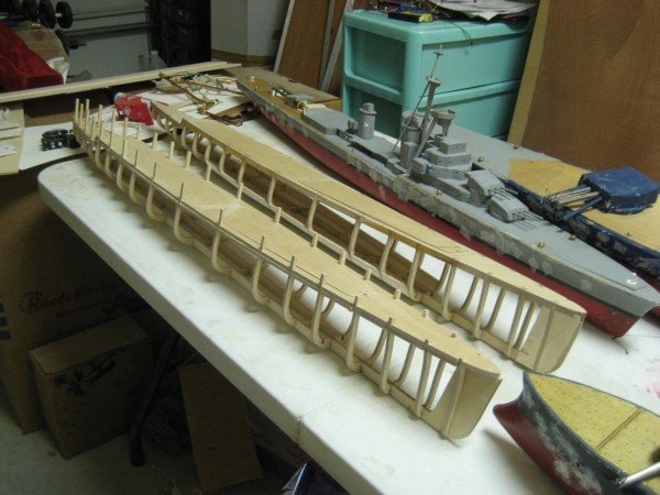

  9. mike5334
    A small update ...
    After basically taking a week off from working on the Omaha hulls to get ready for the IRC Spring Regional, I got right back on the hulls tonight.
    Hull #2 is finally off the building board after finishing up the sub deck doublers and bow frame. Next up for it is a bit of rib and subdeck shaping before starting on the hull bottom.
    Hull #3 will go on the board tomorrow night and get framed up.
    Hull #1 and #2 sitting side by side.

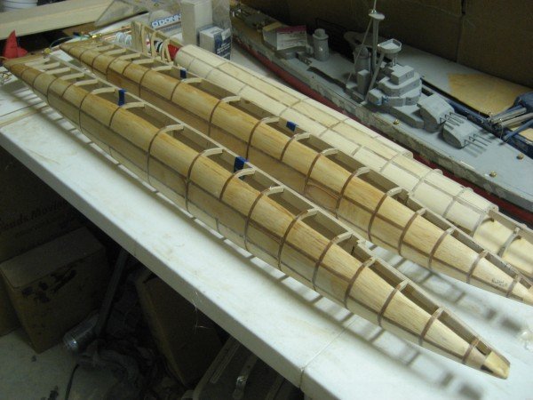

  10. mike5334
    Although it might seem work has slowed on the Omaha hulls, it hasn't! All the building hours have been split between the hulls, which makes the build look slow. Without more excuses, here are some pictures ...
    Before and After pic? Nope. Three of the hulls next to each other in various stages of construction. The middle hull is the most finished, only lacking a layer of fiberglass before being shipped out. The top hull is hull #1, the prototype used to iron out any building errors in hulls #2 through #5. The bottom hull is in the raw, ready to be shape sanded.
    Hull sanded to shape and sitting next to it's sisters. The middle and left hulls will get figerglassed tomorrow (Wednesday) night, trimmed and packed Thursday, and shipped out Friday. Then its time to pick up where I left off on hulls #4 and #5.
    From the stern. The stern on these ships are very narrow. The plan is to move the rudder forwards about 1.5" to get enough space for the rudder comtrol system. Notice two of the hulls do not have the skeg on them ... I'll leave it up to the captains getting those hulls to put them on after planning and setting the prop shafts.

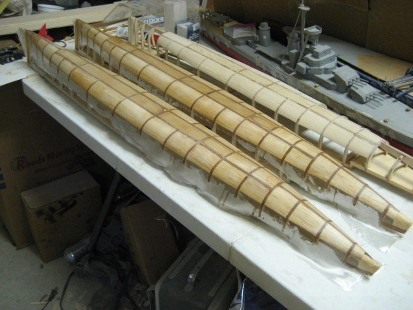

  19. mike5334
    As requested ... :)
    Shortly after getting fiberglassed. Love how wood hulls look at this stage ... the resin really brings out the wood grain.
    All trimmed up and ready for packing! The bow area got two layers of cloth for extra strength.

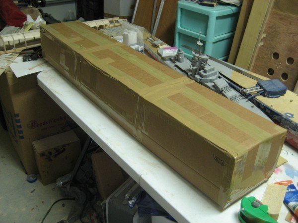

    All packed and waiting a trip to the post office/UPS store. It gets sent Saturday morning. :)
    Hopefully, Dave and Don will be able to post pictures of these two hulls during their outfitting. In the meantime, time for me to get back on the other two hulls!
