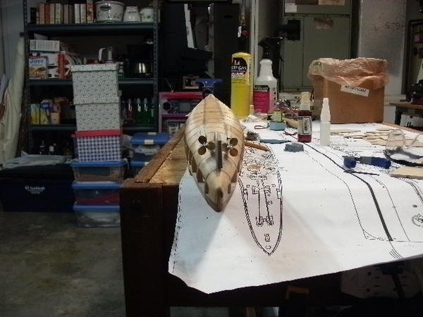

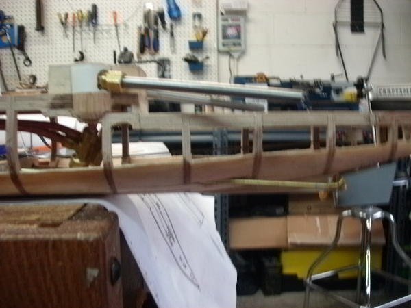

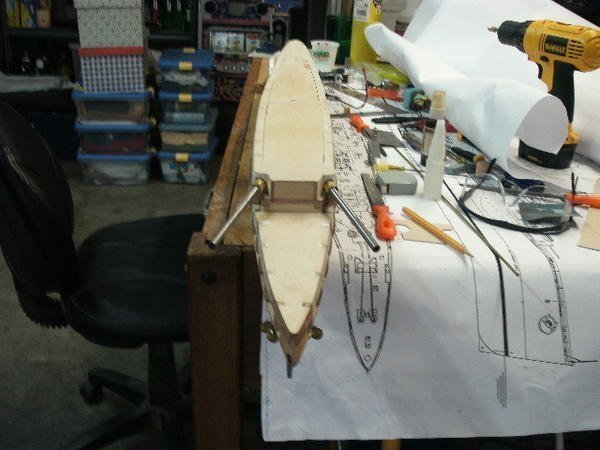

    Just adding to Mike's Post for the build. Don and I cut out most of the Super pieces today, but have done nothing else with them as of yet. I will put the 2 guns together tomorrow, and start working on the super.
    I did make up some stuffing tubes, went with 3/16 tubes, and SS 1/8 shafts. They look pretty good, not oversized, but I still need to put the outer shafts in.
    Here are a couple of pics, with the inner ST's in, and rudder I made up installed. I used a DesMoines rudder, and cut the rudder down to the proper size, with 1 inch props, they look just right, and they are slightly bowed in.
    I did cut too much out of the hull for the first one, but the second went in much better.

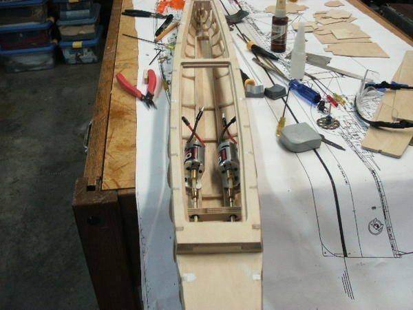

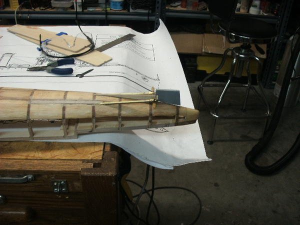

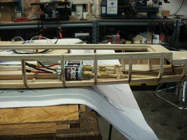

    Worked on it for 7 hours today, but feel like I did not make much progress, all I got done was the motors mounted, was hoping to get the guns made up also, but spent to long on the motors. Was going for the lighest weight possible. They spin nice and free, also installed the rudder linkage to the rudder. I plan on putting the rudder servo in the very back between the guns, so it is acessable since the back deck is fixed into place and does not come off.
    Side view of motors in place.
    Top view
    Not the prettest, but functional.

    Looks great Dave! The twin motor setup will probably be the simplest way to go on those ships.
    Looks like you moved the rudder forward another 1/2" or so from the mark. That should work fine too.

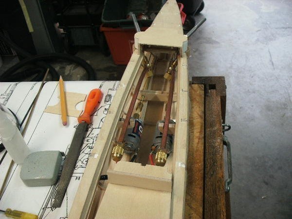

    I did a bit of rear hull mods last night and today, I like simple superstructures, and really like the look of the stacked Casemates, so I cut up the hull a little, added the lower rear casemate back in. That way the rear Super is much simplier. I also got the guns together, and mounted, along with the upper rear deckhouse.
    I still need to decide where I want to put the rudder servo, Mike looking at my pictures, Frank thinks sideways, just behind the guns, any idea's?
    Guns are mounted, 1 ty wrap holds a gun in place. The barrels are 5 inch long, will need to cut those down to between 2 to 3 inch. 15 deg off center, with 10 deg down angle, looks like they will hit right aft of the stern. Should do belows with the 10 deg down angle.
    Side view of gun mount, stacked casemates.
    Rear facing view showing rear deck removed, it slides back, and fits under the rear deckhouse.

    Kinda looks like I missed the little cut out on the rear corner of the upper deck where the lower casements are located. Not sure how that happened ... was thinking I drew up the hull sections to set that. Good catch. Heh. Sometimes it takes another set of eyes to see the things the builder misses.
    I was thinking of sliding the cannons towards the bow if possible until the interrupters were in the center of the ship right over the dogbones. That would probably let you keep most of the barrel length yet only leave a couple inches sticking out of the casement. The superstructure could hide the breech fitting if a opening was made in the rear deck hatch.
    The servo could go behind the interrupters towards the stern and lay flat like the Gloire's servo installation you saw a while back.
  14. djranier
    I looked at moving them forward, but then you cant get the down angle, and you need 8 deg or more for belows.
