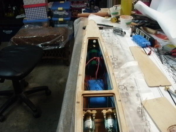

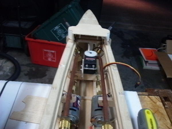

    Finally figured out where and how to mount the rudder. After looking at it for around 15 mins or so, I noticed the crossmember I put in to stiffen the stuffing tubes, the servo looked like it would fit right on it, and between the guns. I went with my trusty home made aluminum mount, its light, strong, and takes less space than a wood one.
    Took me around 2 hours to make up the mount amd install it. All held together by 2 screws, and screwed down to the cross menber with countersunk brass inserts.
    Top view of rudder servo mount. It is below the deck, but I will need to have a small S bend in it to clear the back deck.
    Side view.
    Tomorrow I plan on looking at where the bottle and regulator support will go, and where the solenoids will mount. I plan on using a single 5 amp Nimh pack in her since I can change the packs every sortie, but I may have the weight to run 2, so I will plan on fitting 2 for now.

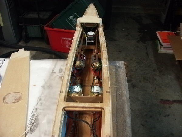

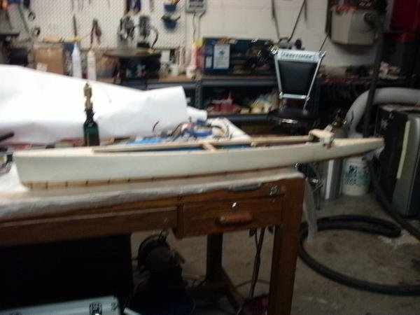

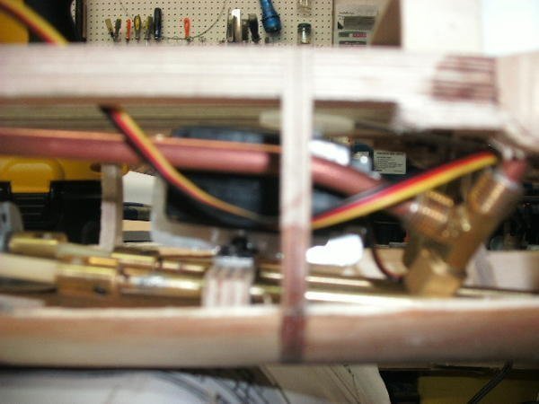

    Got some more work done on the Detroit the last 4 days, went to Rick's today and worked on it for 7 hours. Put in the water channel, waterproofed the insides, sheeted, installed the internal armour, plummed the guns. Looking good, still hoping to have it ready for next Weekend battles.
    Camera always says it focused, but the dang pictures still come out blurry at times. Next shows it without the pump in it.
    With the pump. You can see the bottom of the deck, I'm having to cut some of it away to get it to fit, since the deck is just a little to low to clear the top of the pump.

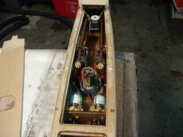

    Forward, with the bottle, and battery in place.
    Now I just need to get the 2 firing boards, receiver, Speed control, and pump controller in it. Looking at using the space between the deck cross member, and the front side of the board holding the solenoids in place.
    With the way she sits now, her weight is 7 pounds 4 oz. With everything in it. Tomorrow I will float test her, and see if I can use a second battery or not, before I begain the wiring.

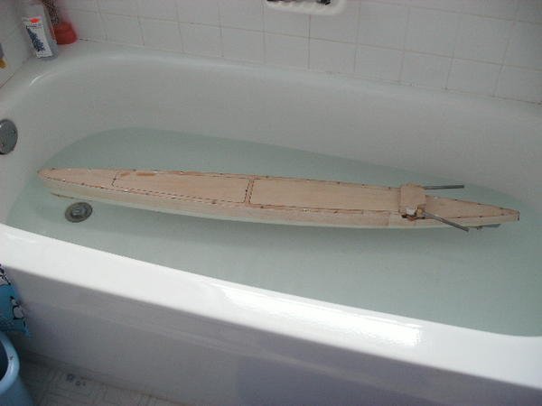

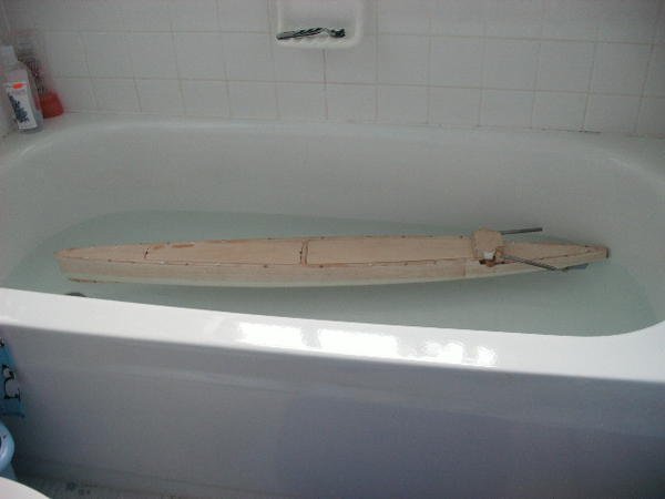

    Couple of pics with her in the Allied test pond, she rode level, looked like it will be just right after adding the superstructure.
    I also still need to add the outer shafts.

    I'm very interested in what the weight will be when it floats at the 1/2" freeboard waterline.
  8. djranier

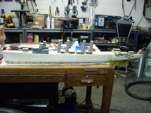

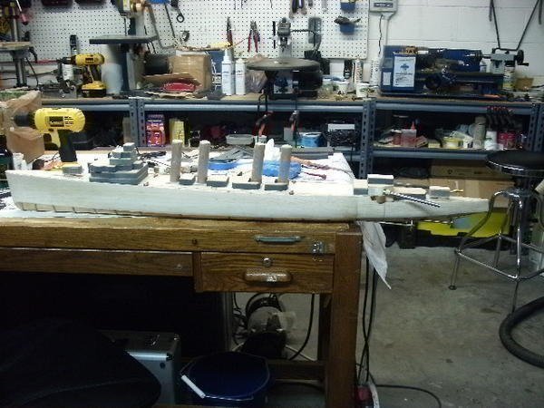

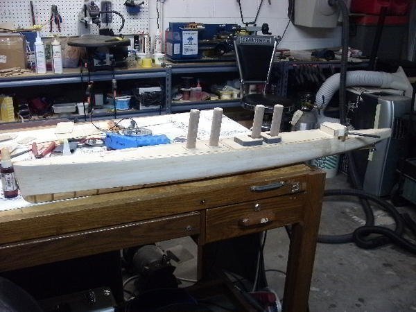

    She is at 7 pounds 4 ounces in the tub, thats with 2, 5 amp SC Nimh's in her. Added the stacks, used a model rocket tube, guled a peice of scrap wood to one end, and filled it with spray foam to stiffen them up, then cut to the right length, and sanded to a 4 deg angle on one end, to give the tilt back. Came out nice. Starting to add some superstructure.

    Had to work this evening, so it will be close if its ready or not, leaving Friday morning for Savannah. I did get some more of the superstructure work completed after I got home. Tomorrow I plan on finishing up the internal wiring hopefully, and maybe some more superstructure work, but the basic structure is in place.
    Turrets are so small they are funny looking.

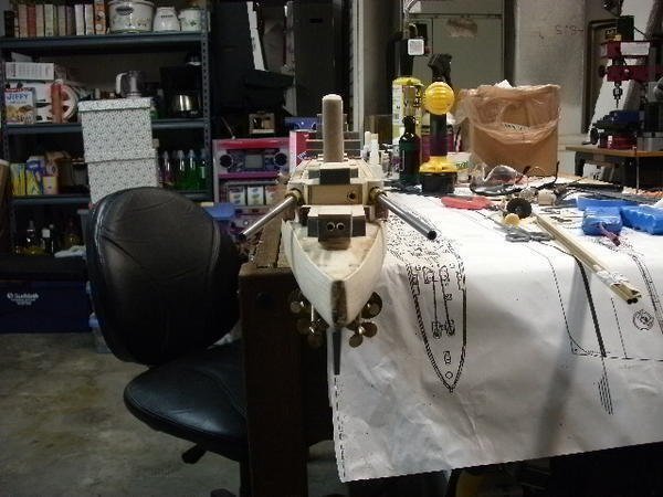

    Got the pump and outlet installed, also added the outer set of shafts. Still need to add forward lower casemates, 6 barrels, since they are all considered main guns, they need to be on the ship. Also the forward tripod mast, stern mast, and plane catapults. And internal wiring. Will not have time to finish it by the weekend it looks like, bummer, work keeps getting in the way.
    Made and installed a new 1/2 unit outlet, real happy with it. Tried close to what Greg talked about. Took a solid peice of brass a bit longer, drilled out one end at 7 deg for the output side, then the other end at 5 deg for the input side. Then drilled the very center out at 3/32 for a 1/2 unit outlet. That way it should act as a nozzle, since the pressure on the output side is lower than the input side, the lower outside pressure will actually help pull the water out, and the water will expand into the 7 deg sloped output, just like a nozzle does in a rocket motor. I made the 3/32 as narrow as possible, around 1/16 of a inch. I can put a peice of 3/32 rod in, it does not move side to side at the center, but can roll around the outer edge, and stick out the other end doing the same thing.
    Latest pics
    Stern view, outer shafts, and outlet added.
