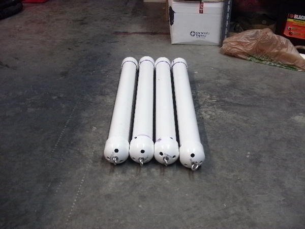

    Made up some new equipment for my boats, can anyone guess what they are used for? Peroxide powered Torpedoes for the Detroit maybe.

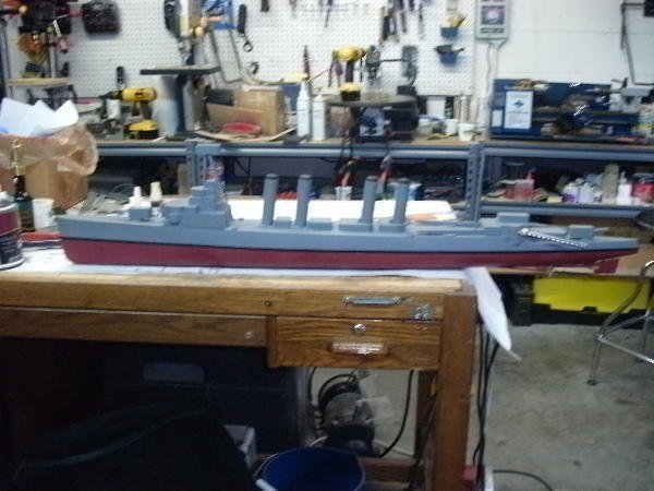

    Ok, got everything packed for the battle, so went back to work on the Detroit. Superstructure if as fully assembled as it's going to get, just need to add the 6 barrels, seal and paint it. Then finish the internal wiring which will not take to long. Just dont have the time to finish before the battle this Sat, were heading out tomorrow morning.

  8. djranier
    Nope its staying right where it sits, will finish when I get back, 2 or 3 more evenings should do it.

    Looks good. How well do those torpedoes work?
  10. djranier
    They are 2 ft long, and 3 in in diameter, so pretty well I would think.
    They are anchors for my tent. Take them down to the water, fill them up, hang one on each corner, end of the day, just empty them out. Save's weight that way.

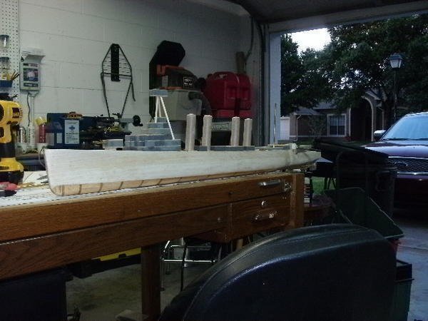

  19. djranier
    Well the Detroit is just about done, need to finish up the wiring, and she will be ready for Rick's this Saturday. Then I think I will put a 1/2 unit pump in my Faa De Bruno, and use her as a gunless block ship, to guard the targets at Nats. Will be hard to shoot around it.

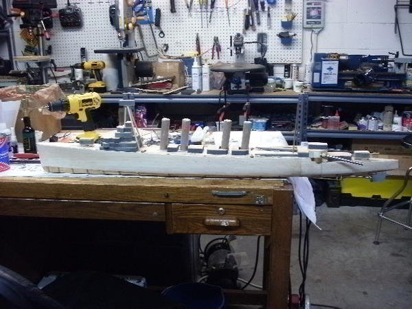

  20. djranier
    Well I finally got her wired up to at least drive her around. Still need to finish up to gun wiring, but thats not too much. She went forward and backwards pretty good. First time I made a turn she layed right over on to her side during the turn, and the end of the bottle, and battery shifted to the side, and she just stayed on her side, so I brought her back to shore laying completly on her side, did not sink, but was getting low in the water.
    Will need to cut down on rudder throw a tad bit for sure. I had two batteries in her, and a heavy regulator. So I will hook up the Strike Reg, and do a little rewiring to just run on one battery. But she is like a wild stallion, super responsive to stick movement, will require alot of practice getting used to her. I kept over correcting, by ocounter steering, but was having a problem making small enough rudder movement, just used to the Iron Duke's slower speed I guess.
