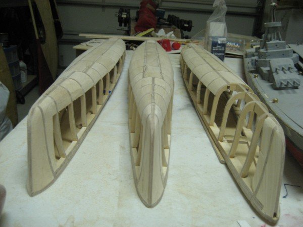

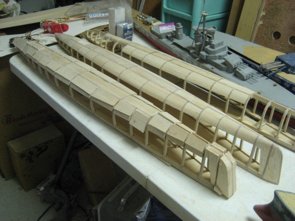

    Cool Ship , I am looking to build my own ship real soon,This part here in the pictures ,How did you get the wood the curve and glue them in ,And what kind of wood did you use from the skin.Any video showing how you did this part.
  6. NickMyers
    Its balsa blocking, he just sanded it to the profile of the ribs fore and aft of the block. If memory serves, the Bearn build thread (On the Ways: Bearn CV | R/C Warship Combat shows it in a little more detail.
