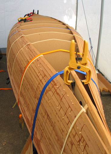

    Depends on the shop I guess.
    Cedar strip canoe under construction

    That's funny, I was going to do cedar on my USS raven Minesweeper, Then sand it smooth ,Then fiberglass .
    What thickness did you cut the cedar into ,and width?
    Would like to see more pictures.< I am not at this stage , But it looks like the cedar planks start at the top.
    Is this standard way of doing it?
  10. SteveT44
    It's not my build. Canoe cedar strips are typically 1/4" thick with bead a cove edges.

  19. SteveT44
    Cedar strip for the bottom of the hull will work fine. If you have a table saw cutting the strips will go quick. After sanding the strips a layer of fiberglass finishes it off.
