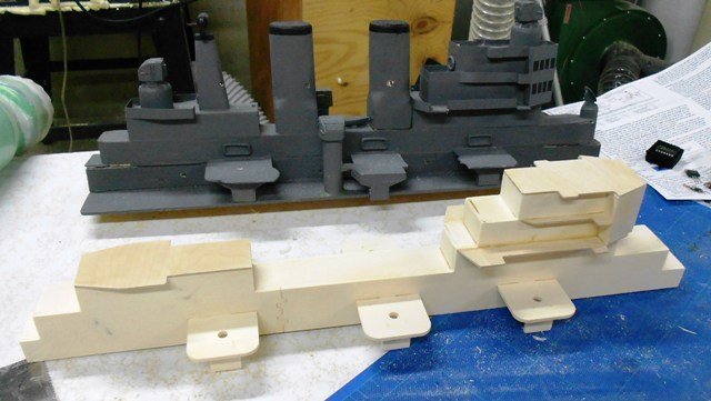

    The old superstructure had taken quite a beating. It was constructed from EPP foam with fiberglass on the outside and built up level by level. So there were a lot of BBs that penetrated between the levels as well as right through the fiberglass.
    I built the new superstructure out of 1/8" lite ply so the sides are one piece. I also simplified the design some - using the same AA platform for all the 3" guns rather than keeping the scale outline.

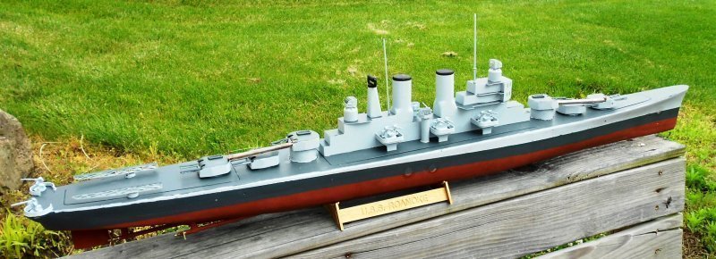

    Here's the re-fitted Roanoke:
    The measure 21 camouflage looks very nice and makes the ship look like it sitting low in the water. I would like to say that the re-fit is complete, but I have a couple of other minor things I would like to do. At least it is battle worthy right now.

    Hey Mark,
    She looks great! can't wait to see her!!! How did you do the Name plate stand???

  6. rcengr
    Dustin is right, I made the ship stand using my CNC mill. It only works well if I have the hull contours in a computer drawing so that the stand fits.
